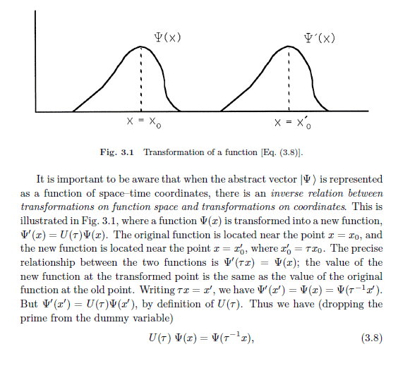

Maybe you're confused about how the group transformations act on the wavefunction. I'm not sure if it's allowed, so if not, mods should remove the screenshot, but I add a screenshot of Ballentine's chapter 3.
You see that (surpressing t)
##U(\tau) \Psi (x) = \Psi (\tau^{-1} x)##
We know that for transformations besides the boosts
##\Psi'(x') = \Psi'(\tau x) = \Psi(x)##
I.e. "the transformed wavefunction at the new point has the same value as the old wavefunction at the old point". All in the same coordinate system!
So if you now replace
## x \rightarrow \tau^{-1} x##
you get
##\Psi'(x) = \Psi(\tau^{-1} x) = U(\tau) \Psi (x)##
Conclusion:
##U(\tau) \Psi (x) = \Psi'(x)##
For the boosts you know to include the extra phase factor.
