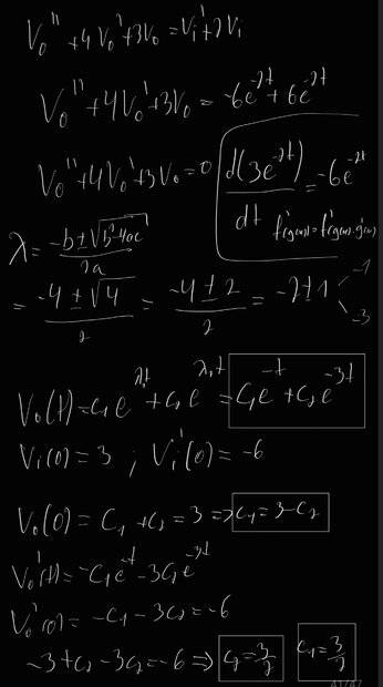

It's a multiple choice exercise and I have managed to find the characteristic equation V0(t) which is ##V_0(t)= C_1e^{-t}+C_2e^{-3t}##
Initially I thought that it was a non homogeneous ODE, but doing the math for the right part of the equation, I found out that it equals to 0.
So, I need help finding the constants ##C_1## and ##C_2## and I don't know how to handle the initial conditions.
If I make ##V_0(0)=0## and ##V_0'(0)=0## both ##C_1## and ##C_2## would be equal to 0, which is wrong.
So, I tried calculating ##V_i(t)## and ##V_i'(t)## and doing ##V_i(0)=0## and ##V_i'(0)=0##, but still got the wrong answer ##(C_1=C_2=3/2)##, while the answer is ##C_1=3/2## and ##C_2=-3/2##.
So, how should I handle the initial conditions in this exercise?

erobz said:
Well if you don’t mind how did you do it? Because I get a system for the coefficients whose only solution is ##C_1=C_2=0## like you said before. It’s somewhat confusing because as you say the RHS is identically 0 for all times ##t##, making the general solution that of a homogeneous ODE?
If you can understand my handwriting, this is how I did it.
Until up to the characteristic equation, I believe I got it right. My issue is with the constants calculation.
As I posted in OP, I did ##V_i(0)=0## and ##V_i'(0)=0##, but I don't know if this logic is correct.
PS: Are ##V_i(0)=V_0(0)## and ##V_i'(0)=V_0'(0)## ?
PPS: Oh, in my last post, the "I think I got it right now", was meant to using Latex, lol. Not the solution of the question

The general solution is $$V_O(t) = C_1e^{-3t} + C_2 e^{-t} $$
Its not dependent on the inputs is it? The inputs add to ##0## for all time ##t##. I think we are going to need a bit more of mathematician here...Its not making sense to me.
If the RHS of the ODE was not zero you would add a particular solution ## y_p## assuming the form of the generalized input ( or forcing term ), but we have literally nothing on the RHS. It's just a homogenous ODE!
Also, initial conditions are on ##V_O## and its derivatives. Not ##V_i##.
I think something is not right about all this, but I'm not anywhere near an expert in solving differential equations...so take what I say lightly.
Maybe @berkeman would move this to the math forums. It's just an exercise in solving ODE's as far as I can tell.

When you went with, and after:
$$ C_1 + C_2 =3$$
I see no justification for that. How did you reason that out?
Initial conditions apply to ##V_o(t)##, and ##V’_o(t)##. If they are both null, and with no forcing function they just stay put at ##0##
$$ C_1 + C_2 =3$$
That was a desperate atempt to find the answer. I did it, not knowing it was right (tbh I thought it was wrong). Now I know is definitely wrong.
This question is from a public test for a government company in my country. So, it should have been disregarded, right (it wasn't, though).

ffp said:
I really think the question is missing something now, reading all you guys answers. This is all all we can get, right?
This is a calculation of the impulse response of a second order linear system (mass - spring - damper).
Are you allowed to use the Dirac delta function? in that case the right side of the differential equation is just δ(t), and you can use the laplace transform.
A an equation with f(V'', V', v) = δ(t) and initial values V = V'= 0 will have the same solution as an equation with f(V'', V', v) and initial values V(0) = 0 and V'(0) = 1.
Since we have two exponentials in the solution, this is an overdamped system.
Impulse Response of Second-Order Systems
I'm not sure I understand what you said. But I still have to calculate the C1 and C2 constants...
$$V_0''(t)+4V_0'(t)+3V(t)=V_i'(t)+2V_i(t)~~~~~~~\text V_i(t)= 3e^{-2t}$$
$$V_0''(t)+4V_0'(t)+3V(t)= -6V_ie^(-2t)+6e^{-2t}=0$$
Then we have the general solution of this differential equation (forcing function=0)
$$V_O(t) = C_1e^{-3t} + C_2 e^{-t}=0~~~~,~~~~V'_O(t)= 3C_1e^{-3t}+C_2e^{-t}=0$$
At time zero we have
$$C_1+C2=0~~~~\text{and}~~~~~3C_1+C_2=0$$
Therefore C1 = C2 =0, what am I doing wrong?
Can you describe how you arrived at answer ##~C_1=C_2=3/2##?
