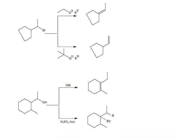

Predict the major product and type of reaction mechanism (E1/E2/SN1/SN2)
Could someone just double check my work for this? From top to bottom I got: E2, E1, SN1, E1

Looks good, but you permuted the last two solutions in the graph.

I think it should be E2(strong base), E2(strong bulky base does E2 hoffman elimination ), E1 and Acid-base reaction followed by Sn1. The bottom two images are shifted tho
