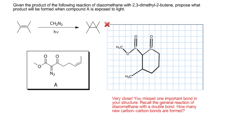

I'm having difficulties figuring out where the new carbon-carbon bond would form. Any help is greatly appreciated. Thank you!

Your product should contain a tricyclic substructure.
Bicyclic, not tricyclic. The important point is what reactive intermediate is formed by the diazo structure.
Likes Natalie456
Correct! What I wanted to say is that it should contain a ring of 3 c atoms as a substructure.
Likes Natalie456
