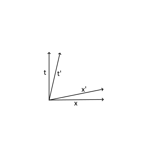

A space-time diagram might help. We'll do a simple case with one space and one time dimension, so we don't have to worry about issues like spatial rotation.
We're representing vectors on the diagram in the traditional way as little arrows. Hopefully this is self explanatory. Perhaps the details of drawing the space-time diagram need more clarification, but I'm really not sure what to say, I am hoping that they are familiar to the OP, at least enough to make my point.
The vectors x and t represent the orthonormal basis vectors of an observer in some frame S, the vectors x' and t' represent the orthonormal basis vectors in a frame S' that is moving relative to S.
Vector x is orthogonal to the vector t. This is true in all frames. The lengths of these vectors are also frame-independent scalars.
The vector x' is orthogonal to the vector t'. This is also true in all frames.
However x is not x', as you can see on the diagram. And t is not t'. They're different vectors. x and t are the basis vectors of S. x' and t' are the basis vectors of S'.
Likes JD_PM
