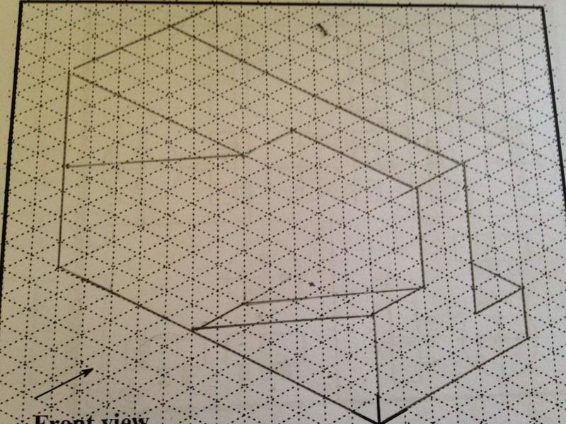

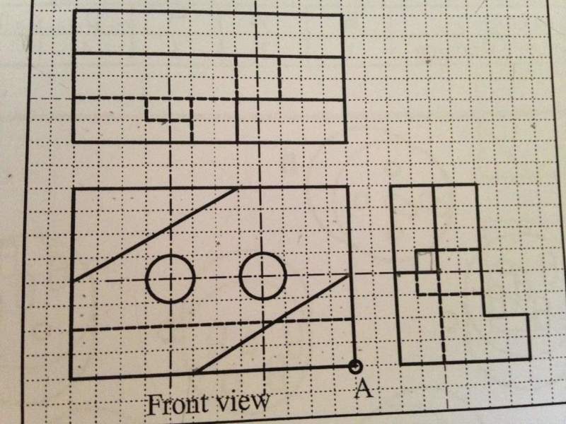

I have to convert the orthographic given into an isometric drawing. I am struggling to visualise the object with the orthographic so if anyone can help me out it would be great
Picture attached
Picture attached. My attempt is hardly complete, but i just want to know if I am on the right track and if I have made any errors

Edit: See correction below.
Not too hard to work out if each of the round things are pegs or holes.
There is something wrong at the bottom left corner of your isometric.
Hi, you mentioned something about pegs or holes which I overlooked before. Am I correct when I say that the left circle is a peg protruding out 1 unit? And the circle on the right is a hole?
Yes, that's what I think.
