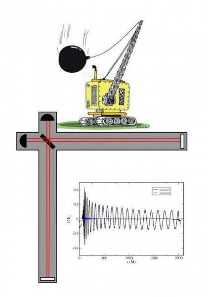

Ok. But when you say "Further, the affect of GW on matter is completely different than the effect of pushing a source back and forth." are you saying that the physics are totally different? Or is it only a difference in the function F(t) which will act on the body. By the way I manage to convert my question in one gracious figure.
What is the waveform graph in this picture supposed to be describing? Do you know how the waveforms of GWs are described?
Of course. No problem in using this terminology.
Now considering the figure I posted, it seems to be, in principle, possible to produce the same effect of Strain vesus Time, on those interferometers by artificially moving a considerable piece of mass in the vicinity of the apparatus.
My question address particularly the possibility of imitating the radiation field through the near field produced by the use of a well controlled gravitational source.
Sorry for having inverted the function. I only tried to express the fact that a pendulum tends to stop and it seemed to be reasonable to propose that this would also happen to the oscillations.
Trying to answer your question, I suppose these oscillations are produced due to a time dependent interference pattern caused by local metric oscillations which change differently the arms of the interferometer.
Basically, yes. But one waveform can't really describe a GW. GWs have two possible polarizations, as shown here:
https://en.wikipedia.org/wiki/Gravitational_wave#Effects_of_passing
So to fully describe a GW, you need two waveforms, one for each of the polarizations; there is no necessary connection between them. (I don't know if LIGO was able to measure both waveforms; they may only have been able to measure one, since one waveform from each detector is all that I've seen in published info.) Also, you have to bear in mind that even if you have both waveforms, that is not a complete description of spacetime curvature, i.e., it's not a complete description of the effects of gravity; see my previous post.
Ok with this part. The complete information about a wave, in general, rarely can be inferred by monitoring the pertubation in one or two locations.
LIGO is sensitive to relative changes in the lengths of the arms only, so each detector is limited to one polarization direction. A gravitational wave that changes both arms with the same amplitude is completely invisible to this detector. Two two LIGO observatories have different orientations for the arms, combining both they can get more data about the polarization. The Livingston site has roughly SSE/WSW orientation, while the Hanford site is SW/NW. The curvature of Earth has to be taken into account as well as the detectors are not at the same place.
