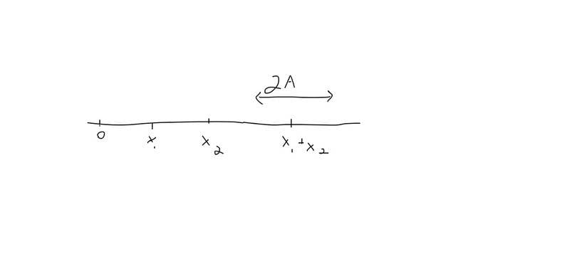

So i see that ##A=\langle x_1 \rangle + \langle x_2 \rangle## and ##B=\int_{-\infty}^{\infty} 2x\varphi_1(x)\varphi_2(x)\mathrm{d}x##.
is the point about the particle oscillates A? but isn't that outside of the range between the two sites? shouldn't that point be somewhere in between the sites? I feel like I'm missing something silly.

if ##\langle x \rangle = x_1 +x_2 + A\cos(\omega t+\delta)##, doesn't that mean the oscillations are about ##x_1 +x_2 ##, which definitely NOT the half way point ##\frac{x_1 +x_2}{2}##?
what am i missing?

razidan said:
how does that change anything? it's just a normalization constant which is applied to everything.
(the a in the superposition is not the same "a" for ##x_1=a##).
I guess it is always possible to redefine the origin to be a point halfway between a and b.
I guess that change the amplitude somehow, implicitly.
But I'm not sure if I'm still comfortable with this... I'm pretty sure there is something wrong my reasoning.
what am i missing?
##|a|^2## is missing from your equations. For normalised eigenfunctions, ##|a|^2 = 1/2##.

But that is just a normalization factor. how does that change anything?
razidan said:
[itex] <x>=\int_{-\infty}^{\infty} \psi(x) x \psi^*(x)\mathrm{d}x=\int_{-\infty}^{\infty} x[|\varphi_1(x)|^2 +x|\varphi_2(x)|^2+2\varphi_1(x)\varphi_2(x)\cos(\tilde{\omega}t) ]\mathrm{d}x [/itex]
This should be:
[itex] <x>=|a|^2 \int_{-\infty}^{\infty} \psi(x) x \psi^*(x)\mathrm{d}x= |a|^2 \int_{-\infty}^{\infty} x[|\varphi_1(x)|^2 +x|\varphi_2(x)|^2+2\varphi_1(x)\varphi_2(x)\cos(\tilde{\omega}t) ]\mathrm{d}x [/itex]
PeroK said:
This should be:
Ohhh... It took me some time, but the light bulb moment finally came.
Thank you so much!
