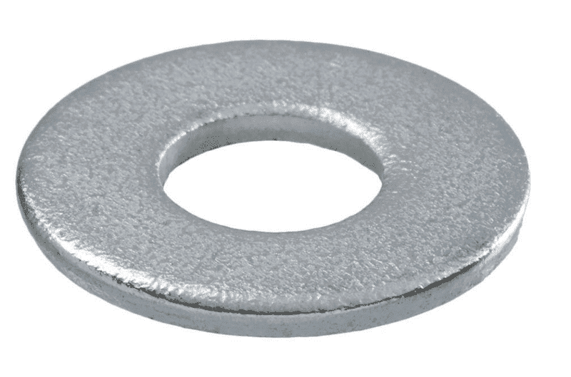

Is the shape really a torus (donut-shaped)? If it is, the dimensions given seem to contradict the description that it's thin. Or is it supposed to be a flat ring of charge with the given inner and outer radii?
A washout ?!?
This is a torus
very clear what is meant with a torus in math and physics.
This is a washer (not a very scientific name, but clear enough)

BvU said:
A washout ?!?
This is a torus
This is the exact shape I was trying to describe. I'm so sorry for ambiguity in definition, English is not m native tongue.
Good; makes life easier. Thin disk with a hole in the center it is. I should have been more suspicious when you mentioned a 'wider ring' and called it a torus.
First expression in post #1 (field of charged ring) looks exactly as the one here , but with ##\ Q\ ## instead of ##\ 2\pi\sigma R' dR' , \ \ ## and -- apart from that -- seems OK to me. This you now want to integrate from ##r_{\rm min}## to ##r_{\rm max}## (instead of from ##0## to ##r_{\rm max}## like here) and there you lose me :
