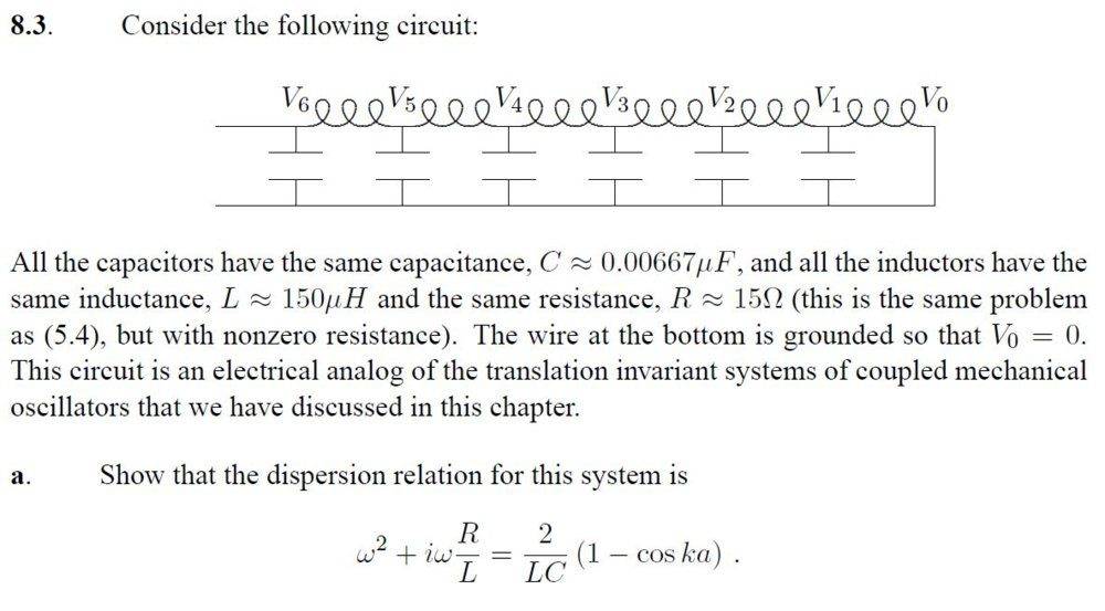

This is a problem from the book Physics of Waves. I have successfully obtained the dispersion relations as required but I have trouble working out the rest of the problem. The problem is as follows in the images.
Kirchhoff's Voltage Law
241500
241501

The above is answer for part A, for part B, I only got one boundary condition, but I can't get the other one and I don't know how to proceed
##Q_0(x,t) = 0##
For the other one, ##V_6 = V_0 cos(\omega t)##
Can someone help me?
I think the other boundary condition is ##Q_6(t)=V_0Ccos(\omega t)##
However, I still don't know what to do next.

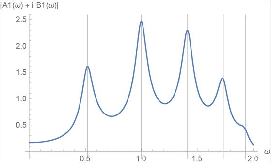

What about part C where it talks about the resonance of this system? I assume that means the local maximums of the amplitude? Do I attempt to put the denominator in terms of ##\omega##? The argument in chapter five referred to should be this:
241681
241680
I'm not really sure what Georgi is asking for in part c. But, it seems to me that as you vary the driving frequency, you would expect to see the local peaks in the amplitude of ##V_1## occurring when the driving frequency matches one of the natural, normal-mode frequencies of a system of 6 coupled LC oscillators. This is discussed some in chapter 3 (section 5).
For part b, I plotted ##|A_1(\omega) + iB_1(\omega)|##, as shown below. The units for ##\omega## are ##10^6## rad/s. I also found the normal mode frequencies for a system of 6 coupled oscillators.
241709
The vertical lines show the normal mode frequencies and they match the peaks very well. But, as I said, I don't know if this is what Georgi meant. Skimming chapter 5, I didn't see anything in particular regarding "finding the resonant frequencies directly". But, I could be missing it.
Likes Miles123K
Wow thank you so much!
I am curious about how you got the normal mode frequency though, would you mind explaining that?
Also, what software did you use to plot this graph?
I used ##V_j \propto \sin(jka)## as in equation (5.81) of the text. The sine function is used in order to give ##V_0 = 0##. In finding the normal modes, we are not driving the system at ##j = 6##. Rather, we have the boundary condition ##V_6 = 0##. This gives the condition on ##ka## for the normal modes: ##ka = n \pi/6##, for ##n## = 1, 2, 3, 4, 5. The dispersion relation can be used to find the normal mode frequency ##\omega## corresponding to each value of ##ka##.
I ignored the resistance (damping) so that ##k## is real here. Chapters 2 and 3 discuss why the resonance frequencies of a lightly damped system are essentially equal to the undamped natural frequencies. See section 3.5 and the example in 3.5.1. Note figure 3.8.
I used Mathematica for the graph.
Likes Miles123K
