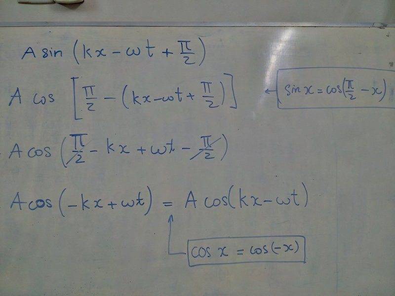

Here's an answer :wink:
Likes grangr
OK, perhaps the long way around.
Realize sin(a+ pi/2) = cos(a)
a = kx-wt
Likes grangr and Nguyen Son
I did that because he/she knows that sin(x) = cos(pi/2 - x), like he/she said above, but he/she didn't know how to solve this problem with sin(x) = cos(pi/2 - x), so I did in that way :D
Sorry, I thought your post was the OP's answer. But you should not post complete answers, just hints.

##\cos(\theta) = \sin(\theta + \frac{\pi}{2}) = - \sin(\theta - \frac{\pi}{2})##
So, both b) and d) are correct.
Likes grangr
Thank you all, Nguyen Son, rude man, and Perok for your explanation. It is much clearer now. :partytime: (And it's good to know that both b) and d) are correct! :wink:)
Indeed, I totally did not recall that cos(x) = cos(-x), or that cos(θ)=sin[θ+(π/2)]. :doh: As it turns out, it wasn't a physics problem to me, but more of a math problem... :sorry:
