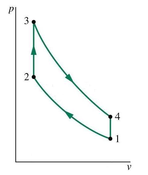

Solving Otto Cycle Problem: Find p2, p3, p4, T2, T3, T4, V2, V3, V4
In summary, the problem is under-defined as P or T is needed for one of the upper points. The equations PVk=const and T1 / T4 = T2 / T3 can be used to find P2 and T2.
Dzai
p1, V1, T1 and ε (compression ratio) are known
I need to find:
p2, p3, p4
T2, T3, T4
V2, V3, V4
but I don't know how to find p3, p4, T3, T4
ε = V1 / V2
V1 = V4
V2 = V3
T1 * V1^(k - 1) = T2 * V2^(k - 1)
T3 * V3^(k - 1) = T4 * V4^(k - 1)
T1 / T4 = T2 / T3
p * V = R * T
R and k are also known
V2 = V1 / ε
V3 = V2
V4 = V1
T2 = T1 * ε ^ (k - 1)
p2 = (R * T2) / V2
And this is where I got stuck
The problem is under-defined. You need either P or T for one of the upper points.
For the process 1→2, use the other equation PVk=const to find P2.
