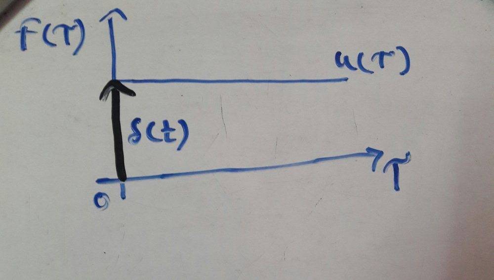

As the title says, I am studying this topic for my control systems fundamentals course. I think I intuitively understand the meaning of the convolution integral that relates input, output and the impulse response, but I am failing to prove it graphically.
For example, the intuitive explanation for this convolution integral is as follows:
Any input can be represented by using time shifted and weighted impulses in succession, and the output at any time t is the superposition of individual impulse responses obtained from each impulse.
This makes sense, but when I try plot it on paper, something looks wrong.

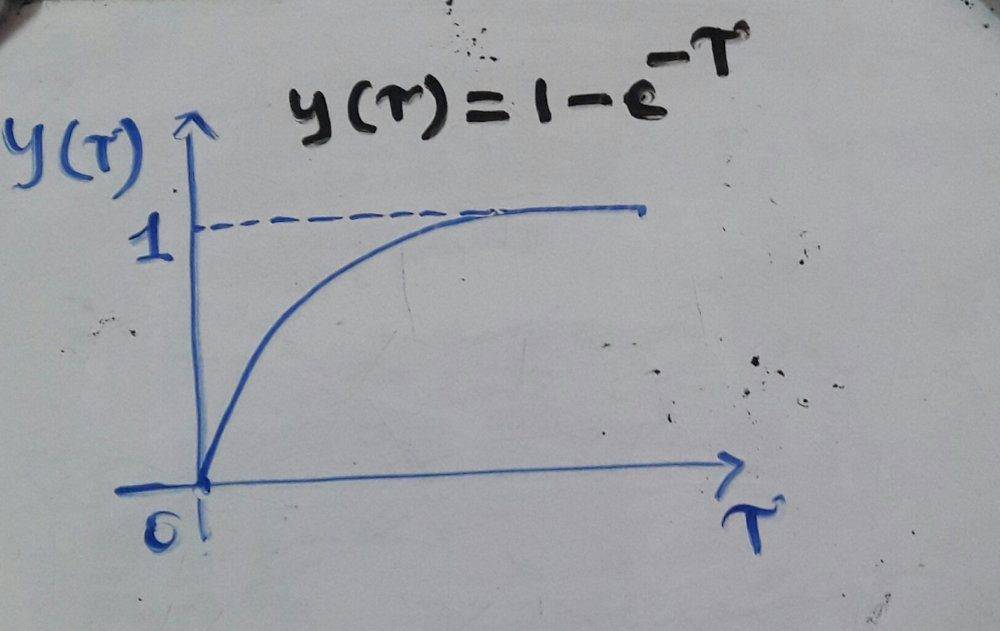

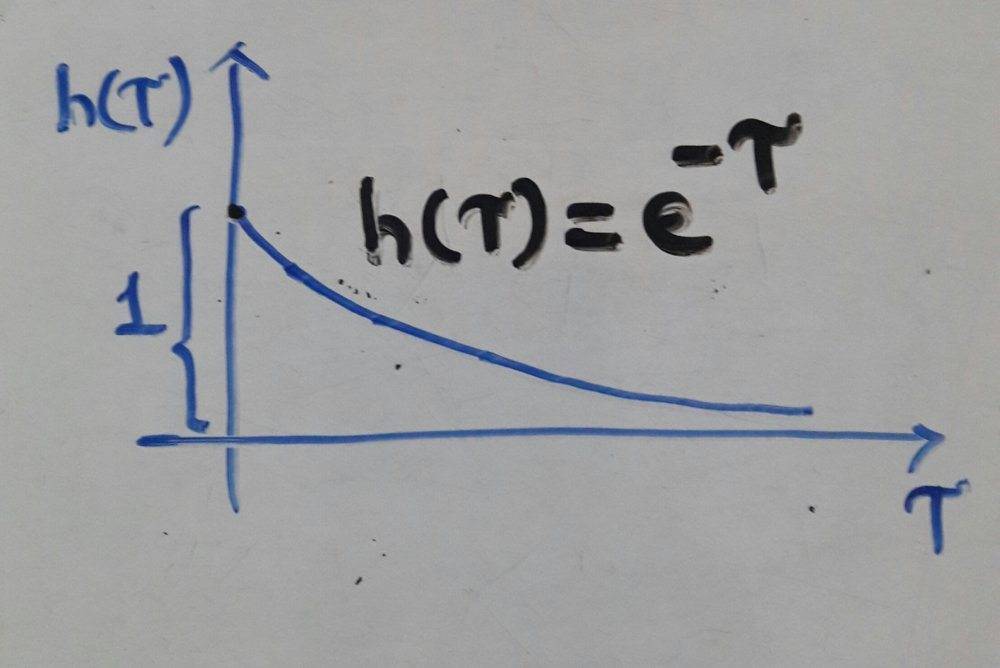

For input x(t)=1...(x>=0) and impulse response h(t)=e-t, output y(t)= 1-e-t
Input:
Impulse reaponse:
Output:
Here, output y(0)=0, but impulse response h(0)=1. What makes y(0)=0 then?
Also, if I pick any instant t=a, the superposition of all the exponentially decaying impulse reaponses at t=a does not seem to give me the correct value of y(a). Where is my mistake? I feel I am missing something very fundamental here.
I sense a slight discrepancy there.
With regards to the input, the definition you provide is correct, but it’s not translating to the input graphic below in that I would have drawn an impulse train, as opposed to the single impulse at zero, to comply with the “weighted & shifted” section of the definition.
With respect to the output definition, again a slight error, but one I suspect might lie at the root of your concern: “the output at any time t is the superposition of individual impulse responses obtained from each impulse” if the input was a unit impulse, which in the case you are considering is not; your input is a unit step function, i.e. x(t)=1 for t>0.

I suspect that here you would just be required to meditate a little more on the idea of superposition, because when you grasp it you’d realize the mistake of ascribing a value to the output at a point based just on the value of the impulse response at that point, since, to obtain a value of the output at a given point, you would shift your impulse response from -ve to +ve infinity, multiply it with the input at every point, and add the all the results at the point of interest to obtain the output value.So, in all, not much here; just a couple of things mostly centered on superposition. But I am happy to continue this conversation.wirefree
Hi chnI believe the answer can be found by thinking about the definition of convolution, also are you using the correct definition of the unit step function?
\text{The unit step function} \,\,\,\,\,\, \epsilon(t) = \begin{cases} 1 & \text{if $ t $ } \gt 0 \\ 0 & \text{Otherwise} \end{cases}
y(t) = x(t) * h(t) = \displaystyle \int_{-\infty}^{\infty} x(\tau) \cdot h(t - \tau ) \,\,\,\, \text{d}\tau
$$So at the point where $$
x(\tau=0) = 0
and
h(t - \tau = 0) = 1$$
we get
y(0) = x(0) * h(0) = \displaystyle \int_{-\infty}^{\infty} \bigg( x(0) = 0 \bigg) \cdot \bigg( h(0) = 1 \bigg) \,\,\,\, \text{d}\tau = 0
