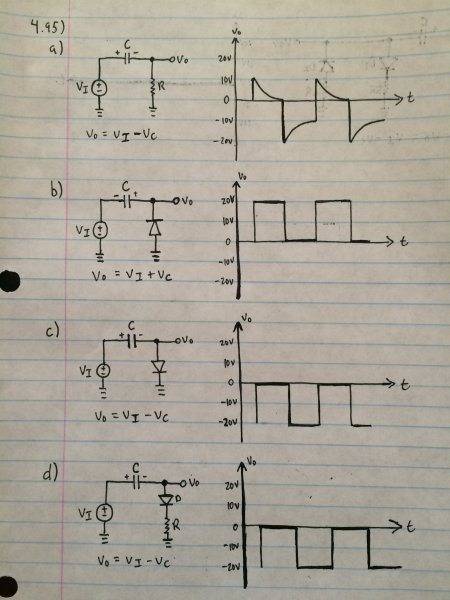

For the circuits shown, each utilizing an ideal diode (or diodes), sketch the output for the input shown. Label the most positive and most negative output levels. Assume ##CR > T##.
The input waveform is given by:
I have re-drawn all of the circuits in my solution, which is shown below.
I have drawn the circuits next to each output waveform below:
Do these look alright? In specific part d) and e) I am not 100% sure about.
In (d) when the capacitor has no discharge path the output voltage will not droop.
Also, in (a), consider that, at the instant the input flips polarity, the capacitor has just been charged to the supply voltage. Should the voltage across the resistor then be 10 V/-10 V?
In (e), is the situation really any different than in (a)? There's always a current path through a resistor.
So I'll assume the b) & c) waveforms look okay.
As for the waveform in a), I don't see anything wrong. When ##v_I = +10V##, applying KVL gives ##v_o = v_I - v_c = 10 - v_c##, which results in the waveform having a peak of ##+10V##. The peak will decrease as the voltage across the capacitor increases. A similar result occurs during the negative half cycle where ##v_o = v_I + v_c = -10 + v_c##. The waveform will have a negative peak at ##-10 V##, which will increase as the capacitor voltage increases. So I believe a) is correct.
As for part d) I see what's happening now. During the positive half cycles, the output wave will once again obey ##v_o = v_I - v_c = 10 - v_c##, except the peak will be clamped at zero. So the first part of the wave I've drawn is okay. During the negative half cycles, you may as well replace everything with an open circuit and have ##v_o = v_I = - 10V##. So this will be a flat line with ##v_o = -10V## for the negative half cycle. Then ##v_o## will shoot back up to zero, etc, etc.
I'm pretty sure e) is correct as well now after thinking about it a little bit.
You should be consistent with the reference polarities you choose. If you assign the reference polarities such that it goes - vI +, + vC -, + vo - as you traverse the loop clockwise, then this equation:
vo = vI - vC
is always true.
If you have vI = 10 V for a while, then vC = 10 V, so if the polarity of vI then flips, you have:
vo = vI - vC = -10 V - 10 V = -20 V.
Same thing goes when the polarity of vI flips again.
Zondrina said:
As for part d) I see what's happening now. During the positive half cycles, the output wave will once again obey vo=vI−vc=10−vcv_o = v_I - v_c = 10 - v_c, except the peak will be clamped at zero. So the first part of the wave I've drawn is okay. During the negative half cycles, you may as well replace everything with an open circuit and have vo=vI=−10Vv_o = v_I = - 10V. So this will be a flat line with vo=−10Vv_o = -10V for the negative half cycle. Then vov_o will shoot back up to zero, etc, etc.
Like NascentOxygen wrote, the capacitor has no discharge path. If you think about it, if you let it run for a little while, why should this circuit behave any differently than the one in (c)?
It's not. The diodes have no effect. You should have the same waveform as in (a), just with a longer discharge time due to the increase in resistance. It says 2R, right?
Edit: I should have tried to explain more here. In (e), if you consider the instant when vI flips to 10 V, then vo = 20 V, and one diode is forward-biased, and the other is reverse-biased. If you then think in terms of what equivalent circuit you could replace it with..
In the one you have labelled (a), you probably shouldn't assume that vo will drop right back to zero each half-cycle. You haven't got the amplitude right. When the input transitions, it is a step change of |20| volts.
I'd say (e) deserves more thinking about.

In your solution, why did you change the reference polarity in (b)? That's not necessary, and I think it's part of why you're confusing some things here.
If we make the assumptions I've already described, then I think your solutions for (b-d) look fine, but it's a little incomplete if you can't see the relationship to the input waveform.
I deleted my previous posts. Your (b) and (c) are correct. (I hadn't noticed the input going negative).
I think (d) needs more thinking. (d) is correct "in the long run" but perhaps you should show how the waveform changes slowly from t=0 until it reaches what you've shown.

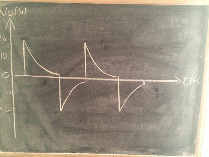

My concern is part (a). I have a simple RC circuit, and some questions.
If I say that ##v_I = -10V## just before the first period of the waveform labelled on the input waveform diagram, then ##v_c = - 10V## and ##v_o = v_I - v_c = 0V## since no current is flowing through ##R##. So the graph of ##v_o## is equal to zero currently.
Then ##v_I## abruptly changes to ##10V##, hence ##v_o## jumps up to ##20V## (ideally) exponentially. This means there is a current across ##R## and hence an output voltage.
Now I have questions. What actually physically happens at this point? Does the capacitor voltage change at all?
If ##v_c## does change, does it charge up to ##+10V##? This would mean the graph would start decreasing exponentially from ##20V## to ##0V##.
Then ##v_I## would change again to ##-10V## and ##v_o## would change abruptly to ##-20V##. Then through another charging cycle, the output would make its way back to ##0V## before changing abruptly again.
Since ##RC > T \Rightarrow \frac{1}{RC} < \frac{1}{T}##, the output waveform would have a lower frequency, and hence a longer wavelength than the input waveform.
The voltage across a capacitor does not change instantaneously. The current through R is changing the charge on the capacitor, over time. If the voltage on one side of a capacitor is abruptly changed by dropping 20v, then the voltage on the other side must drop by that same amount because there has not been any time for the amount of charge on the plates to change in that zero amount of time.
It is preferable that you phrase the discharge of a capacitor as, e.g., its voltage decreases exponentially from 10 towards zero, as being a decaying exponential you probably haven't determined what it actually drops to, and it's unlikely to reach 0.000v here.
There is no substitute for a sketch of the waveforms, both current and voltage, to consolidate ones understanding.
The driving waveform is the input, the output will have exactly the same frequency.
Zondrina said:
My concern is part (a). I have a simple RC circuit, and some questions.Then ##v_I## abruptly changes to ##10V##, hence ##v_o## jumps up to ##20V## (ideally) exponentially.
Not exponentially. A +20V step, as you've shown. Then an exponential decay towards 0V, but never reaching it (see below).
It eventually charges to +10V if you were to wait long enough for the falling edge. +10V on left side, 0V on right. But in this case T < RC so the output does not get close to 0V.
The capacitor never charges to + or -10V. The time constant RC is too large. It charges to + and - maybe 5V, depending on RC.
It does not get close to 0V since RC > T. This would be true if T >> RC.
No. See previous post. If RC > T the output never gets close to 0V but the frequency is the same. The edges are still 20V in height.
So the graph starts at ##0V## and jumps up to ##≈20V## immediately at the beginning. Then it starts decaying towards ##0V## exponentially.
So the output never gets to ##0V##, but hovers above ##0V##.
So are you saying the waveform looks something like this:
I tried to make it look like the waveform never reaches zero and decays exponentially. Without actual knowledge of the circuit parameters, I can't really tell how fast the exponential decay happens, so my waveform may look a bit "fatter" than what you may have had in mind.
That is a good blackboard sketch, and it correctly has an average value of zero.
That's very close to it! But the vertical parts are 20V in height so they don't reach either + or -20V.
So, a) makes more sense now.
For b) the capacitor charges up to ##v_c = -10V## during the negative half cycle of the input. This is because the diode is conducting during that time, and so ##v_o = v_I - v_c = -10V - (-10V) = 0V##. Then when the positive half cycle of the waveform comes through, the diode stops conducting and current flow stops. The capacitor is retaining is voltage due to the reverse bias of the diode and so ##v_o = 20V##. Then when the negative cycle comes back through, ##v_o = 0V## again.
For c) the capacitor voltage charges up to ##v_c = 10V## during the positive cycle when the diode is conducting. So ##v_o = v_I - v_c = 10V - 10V = 0V##. During the negative half cycle, the diode stops conducting, and the capacitor retains its voltage. This implies ##v_o = -10V - 10V = - 20V##.
Now I'll try d). During the positive half cycles of the input, the diode is conducting and ##v_c = 10V##. So we have ##v_o = v_I - v_c = 10V - 10V = 0V##. During the negative half cycles, the voltage on the capacitor remains the same, and so ##v_o = -10V - 10V = -20V##. So the waveform will be identical to c).
Now for e). Just before the first positive period of the waveform, diode ##D_2## is conducting, ##v_c = -10V## and so ##v_o = v_I - v_c = -10V - (-10V) = 0V##. Then ##v_I = 10V## and the output abruptly changes to ##v_o = 20V##. The output then decreases towards ##0V## as diode ##D_1## conducts and causes ##v_c## to charge up to ##v_c = 10V##. Then ##v_I = -10V## again, and ##v_o = -20V## right away. The capacitor then charges back up to ##v_c = -10V## and the cycle continues. I should also note that because the resistance is ##2R## this time, ##2RC > RC## and so the waveform for e) will look exactly like that of a), except the discharge cycles will be longer.
My answer for e) does not take into account the capacitor never fully charges up to its maximum voltage. It also does not take into account the voltage never really equals to zero before changing abruptly.
The diode stops conducting as soon as -10V is reached at the input.
Same argument as for (b) with all polarities reversed.
Only eventually (t >> RC). You might want to draw the waveform as it changes from the first few input pulses to when t >> RC.
