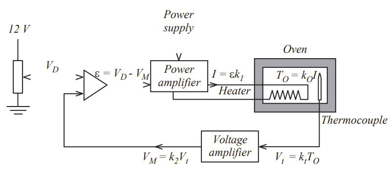

Oven controller block diagram, transfer function and temperature calcs
In summary, the transfer function of the system shown in Figure 5 is a function of the system parameters k1, k2, kO, and kt. The gain of the voltage amplifier, K2, is fixed. The oven temperature is determined when the potentiometer is at its midpoint.
Anfo
Anyone able to help a bit? I have drawn the block diagram but don't think it's quite right.
FIGURE 5 shows an electrically heated oven and its associated control
circuitry. The current, I, to the oven's heating element is fed from a
voltage-controlled power amplifier such that I = EK1. A voltage, VD, derived
from a potentiometer, sets the desired oven temperature, TD. The oven
temperature is measured using a thermocouple that, for simplicity, is
assumed to generate a constant emf of 10 uV per degree Celsius. The effect
of the ambient temperature is ignored.
(a) Represent the arrangement by a conventional control-system block diagram. Identify the following elements in the block diagram: input; error detector (comparator); controller; controlled element; detecting element and feedback loop. (b) Derive an expression for the transfer function of the system, in terms of the system parameters k1, k2, kO and kt. (c) Using the data given in TABLE A, calculate the oven temperature when the potentiometer is at its mid-point.

Also, I'm a bit confused as to where K2 will be. The power amp is K1 and the oven is Ko?

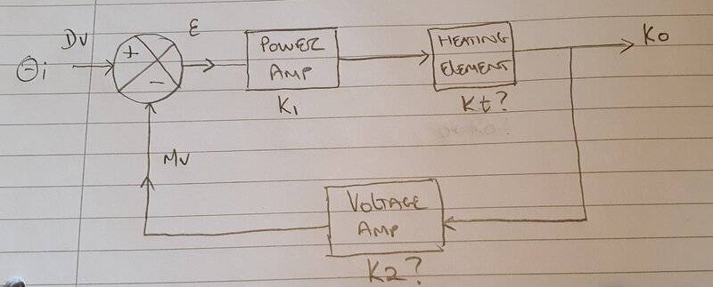

Can you post your attempt ?
I am new to this subject and a bit confused as to where the output will sit. Is that Ko?
Needless to say I need to get this part right to be able to work out the transfer function expression. Apologies if a stupid question but any help or guidance will be much appreciated!

I only see a lower case ##k_0## in this exercise, and it is a fixed parameter (6.9 ##^\circ C/A##).
I would expect the oven temperature is a good candidate for the quantity that is to be controlled.
In your picture:
  • The heating element converts a current into a temperature. There is no ##k_t## there (and no ##K_t## either)
  • I miss
    • In the feedback path: the thermocouple
Next step: write out the transfer function
Likes cnh1995 and berkeman
I see what you mean, so I would need to add another block in the feedback path for the thermocouple. The small signal will then be amplified by the voltage amplifier.

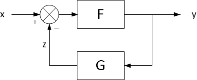

And with operational amplifiers too. Very useful, so let me explain (from control engineering 101, 50 years ago :wink: ) :
Under condition of linearity: going straight from x to y:$$\begin {align*} y &= F(x-z) = F(x)-F(z) \\ \ \\ z & = G(y) \\ \ \\
y&=F(x) - FG(y) \\ \ \\ (1+FG)\;y &= F(x) \\ \ \\ y &= {F\over 1+FG}\ x \end {align*}$$
##{F\over 1+FG} ## is the transfer function. As you can see, trouble breaks out when ##FG=-1## ...

Personally, I liked the expression ##\displaystyle{T=V_D\,{ k_1 k_0\over 1+k_1 k_0 k_t k_2}}## much better than the numerical outcome: You can check the dimensions (to check the line of thought) and estimate the order of magnitude of the result (to check the calculator work).
