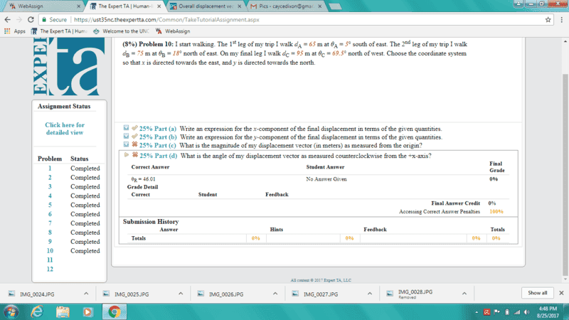

I start walking. The first leg of my trip I walk 65 meters at 5 degrees south of east. The second leg of my trip I walk 75 meters at 18 degrees north of east. The final leg of my trip I walk 95 meters at 69.5 degrees north of west. Choose the coordinate system so that x is directed towards the east and y is directed towards the north.
Write an expression for the x component of the final displacement in terms of the given quantities.
Write an expression for the y component of the final displacement in terms of the given quantities.
What is the magnitude of my displacement vector (in meters) as measured from the origin?
What is the angle of my displacement vector as measured counterclockwise from the +x axis?

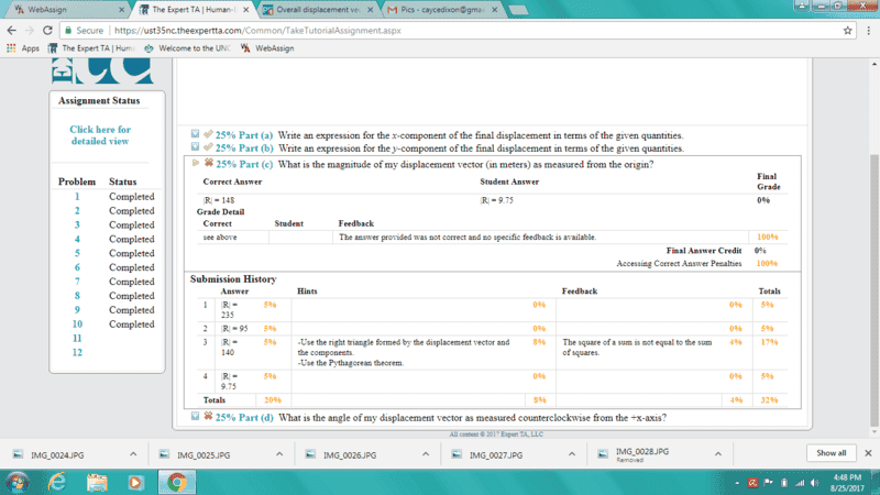

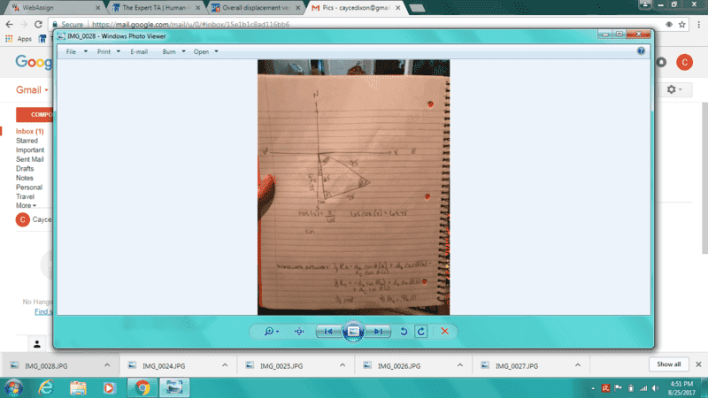

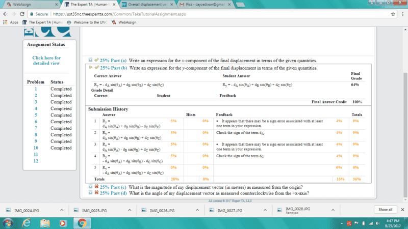

I was able to do a few print screens of the homework problem. As you can see I do not need the answer. I have already tried for 2 days and given up so I only received 50% credit for the problem. I want to know how to solve this problem for when it arrives again. I lucked up on the first 2 questions but only because I used the feedback given.
here is my triangle I drew

You seem to be assuming that the trip ends back at the starting point. Given the questions, that is hardly likely.

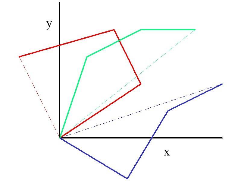

I haven't given you the actual diagram for your problem but here are three different examples of the type of diagram that you need to draw .

You should not have a triangle, because your last point does not land back at the starting position.

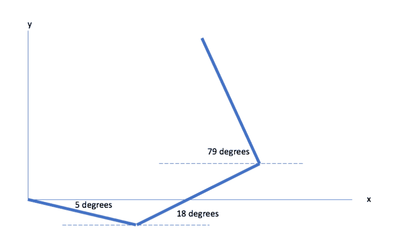

In the figure, I meant 69.5 degrees rather than 79 degrees.

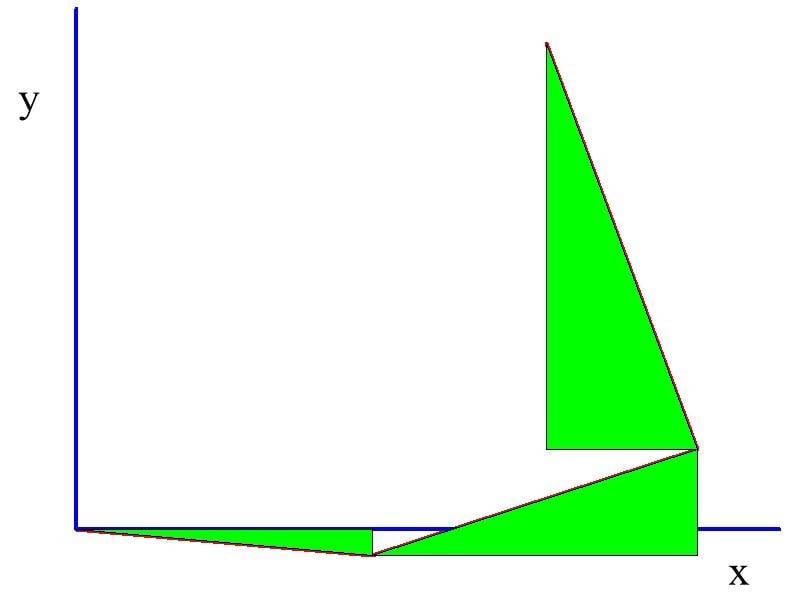

Each "leg" of your trip forms a vector (since it has a length and a direction). If you look from the start to the end of the vector AB for the first leg, you go ##x## units in the easterly direction and ##y## units in the northerly direction, so that single portion of the trip can be thought of as a kind of triangle: it has a base ##x## an height ##y##, and a 90 degree turn from east to north. In fact, if you walked due east by ##x## units and then due north by ##y## units, you would end up in exactly the same place as in the first leg of the trip. The hypotenuse of your little triangle is, of course, the actual leg of the trip, going off at a certain angle for a certain distance. (Note that if ##y< 0## you go ##-|y|## units north, which is actually ##+|y|## units south. Similarly, a negative easterly step is actually a positive step in the westerly direction.)
Following that you go along another leg of your trip and so you have another vector and hence have another triangle. If you had stopped at a 2-leg trip (AB then BC) you would, indeed get a true triangle ABC whose sides are the first leg AB, the second leg BC and the total vector CA from finish to start.
However, that is NOT what you have: your trip contains a third leg CD, so now the figure ABCDA is a quadrilateral, not a triangle. (If you had made a fourth leg DE your "figure" ABCDEA would now be 5-sided, a kind of pentagon, etc.)
Anyway, for your 3-leg trip, you need to figure out the total displacement you make in the east ##(+x)## direction and the total displacement you make in the north ##(+y)## direction. That will tell you the final position after the third leg of your journey. From that you can figure out how far you are from your starting point, and what would be the angle from the start to the final point.

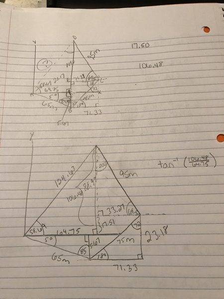

I have posted a photo of what I tried again with creating triangles and I still can't come up with the answer that they have. What am I doing wrong?

You seem to have used 64.75 as the net x displacement, but that is only the x displacement from the first leg.

Type out your work, so we can see clearly what you are doing. Your picture does not show the whole solution, so it is impossible to say what you are doing wrong.
Nidum said:
Thank you so much for this diagram. I kept drawing the wrong triangles which made it impossible to get the right answers. Now that I had the right triangles, I could solve the problem without any issues.
