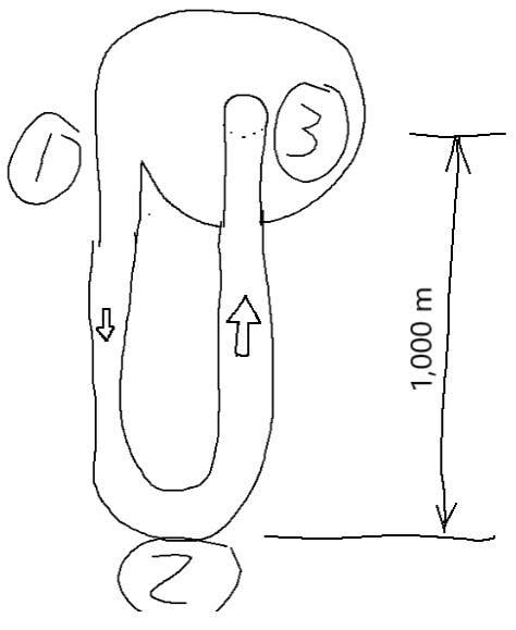

Background:
I am seeking the method of solving the following problem. I’m trying to work through a real-world problem and am stumped on P=ρ *g*h when h is large (density changes significantly)(vapor/gas). I tried to isolate the issue from my bigger problem to help find a formulaic way to solve this. I hope I have formed my question correctly and have not contradicted myself in the process. Below I will show why straight P=ρ *g*h does not work and then explain my approach… for your appraisal.
Problem:
Q: What is the pressure at the bottom of a U-Tube?
In the land of Jack and the Bean Stock, we have a U-Tube that is ridged and well-insulated attached to the bean stock with the top at 1,000 m above the ground (bottom at 0 m). The tops of the U-Tube is connected together with a pump moving 1 kg/minute of CO2 vapor. The pressure at the inlet side is 1 bar (100,000 Pa) and the entropy is 2.5 kJ/kg-K. What is the pressure at the bottom? Consider the system as frictionless. The flow is laminar and steady-state.Diagram 1 - Shows State 1, 2, 3
Standard approach (that does not work) of P=ρ*g*h
Substance: CO2
Flow rate: 1 kg/minute
Entropy: 2.5 kJ/kg-K
Height: 1,000 m
P1=1 bar = 1,000 Pa
State 1:
P1 = 1,000 Pa
s1=s2=s3=2.5 kJ/kg-K
From NIST webbook:
ρ1=2.4147 kg/m3
State 2:
Solve for P2
P2=P1 + (ρ1*g*h)
P2=123,664.06 Pa
From NIST webbook:
ρ2=2.8349 kg/m3
State 3:
Note: if we use the same method we should get State 2 = State 3 since we are frictionless and insulated given that adiabatic process is reversible
Solve for P3
P3=P2 - (ρ2*g*h)
P3=95,882.04 Pa <=== Not equal to P1
My approach:
Ideally, I would like to start by using the pressure in the middle then find the pressure at the top and bottom by
P1=Pmiddle - (ρmiddle*g*(1/2)h)
P3=Pmiddle + (ρmiddle*g*(1/2)h)
Since I don't know the middle pressure (or if this is a valid approach) I then have to just go by trial and error until I am close... not exactly an elegant approach.

Why don't you try it first for the case where there is no flow? The equation to use is $$\frac{dp}{dh}=\rho g$$ where the density ##\rho## is calculated from the ideal gas law, such the $$\rho=\frac{pM}{RT}$$with M being the molecular weight of the CO2, R being the universal gas constant, and T being the absolute temperature.
Likes Lnewqban and vanhees71
Thanks for the reply Chestermiller. I thought I had started with your formula ##\frac{dp}{dh}=\rho g## but ran into difficulties. I tried to formulate this problem using a U-Tube to illustrate my confusion. (It is very likely I am just confused in my lack of understanding, and the rest of you can't see what I am getting stuck on.)
State 1 (top of U-Tube)
I know Pressure ##P_1=1 [bar]=100,000[Pa]## and Entropy ##s=2.5 [kJ/kg-K]## and am able to look up from a table ##\rho_1=2.4147 [kg/m3]##
Using your formula:
$$\begin{align*} \frac{\Delta p}{\Delta h}&=\rho g \\
\Delta p &= \rho g \Delta h \\
\Delta p &=2.4147 [\frac{kg}{m^3}]*9.8[\frac{m}{s^2}]*1000[m] \\
\Delta p &=23,664 [Pa] \\
P_2 &= P_1 + \Delta p \\
P_2 &= 100,000 [Pa] + 23,664 [Pa] \\
P_2 &= 123,664 [Pa] \\ \end{align*}
Now that I have the pressure at the bottom of the U-Tube I should be able to reverse the process and get ##P_3##. Since the process was adiabatic (reversable) it should equal ##P_1##.
Since the pressure at final state does not equal the pressure at the initial state (see original post) I am at a loss how to proceed.

The equation for the density of CO2, treated as an ideal gas is: $$\rho=\frac{pM}{RT}$$At a pressure of 1 bar and a temperature of 298 K, this yields a value of 1.776 kg/m^3 for CO2 (rather than 2.4147).
My two formulas reduce to $$\frac{dp}{dh}=\frac{pM}{RT}g$$ or, equivalently $$\frac{dp}{dh}=1.776g\frac{p}{p_0}$$where ##p_0=100000\ Pa## and p is the pressure at depth h. If I integrate this equation from 0 to h=1000 m, I get $$p=p_0\exp{\left(\frac{1.776gh}{p_0}\right)}=100000\exp{\left(\frac{17400}{100000}\right)}=119000\ Pa$$
Shouldn't we assume an isentropic process?
$$ \begin{align*}
dp &=\rho gdh \\
dp &= \frac{pM}{RT}gdh \\
dp &= \frac{pM}{RT_0\left(\frac{p}{p_0}\right)^{\frac{\lambda - 1}{\lambda}}}gdh \\
dp &= \frac{p^\frac{1}{\lambda}Mp_0^\frac{\lambda-1}{\lambda}}{RT_0}gdh \\
\int\frac{dp}{p^\frac{1}{\lambda}} &= \int\frac{gMp_0^\frac{\lambda-1}{\lambda}}{RT_0}dh \\
\frac{\lambda}{\lambda - 1}\left(p^\frac{\lambda-1}{\lambda} - p_0^\frac{\lambda-1}{\lambda}\right) &= \frac{gMp_0^\frac{\lambda-1}{\lambda}}{RT_0}(h_0 - h) \\
p &= \sqrt[\frac{\lambda-1}{\lambda}]{\frac{\lambda - 1}{\lambda}\frac{gMp_0^\frac{\lambda-1}{\lambda}}{RT_0}(h_0 - h) + p_0^\frac{\lambda-1}{\lambda}}
\end{align*}$$

I tried to set up the problem with enough flow in a steady state to force it to be an isentropic process with ample insulation and ridged.
Chestermiller said:
If there is no flow, why would we assume an isentropic process? Even if there was flow, it would depend on the flow rate and heat transfer characteristics of the system.
It's experimentally easy to demonstrate that you have an adiabatic process with good accuracy by simply measuring the sound velocity in air. You get the adiabatic not the isothermal value.
If there is no flow in the tube, the system will eventually be isothermal.
Then the thing to do is to use @jack action's results to get the downhole pressure. But, understand that you are also assuming that there is negligible viscous friction affecting the pressure variation. If there were viscous friction, the pressure variation would be different, and the assumption of isentropic flow would also be invalid. Also, you would have to employ a significant pressure difference between the inlet and outlet of the U-tube.
So, try the calculation over again with jack action's equation. It should also be possible to use his equation to show that the pressure variation in the up-leg of the U-tube is such that, at the top, the pressure is again 1 bar.

No. This is a U-tube where, with no flow, parcels of gas can't move upward and downward by circulations like in the atmosphere.
Hm, but the above calculation still applies. The only question is, whether you have an adiabatic, isothermal, or more general situation. I'm not too sure about that question here. Anyway, you find the solution for any polytropic EoS above ;-)).
Using the simplified form of @jack action's formula I presented in post #13, at a depth of 1000 M, using ##\lambda = 1.28## for CO2, we get:
$$p=100000\left(1+\frac{0.28}{1.28}\frac{174000}{100000}\right)^{\frac{1.28}{0.28}}=118620\ Pa$$
Likes vanhees71
