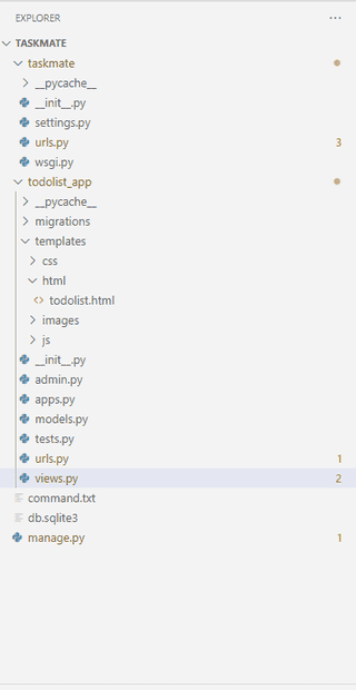

This is my folder structure.

I'm suspecting that the problem is in my main project urls.py as I've not included any details about contact and about URLs there. So, I did this there.
Python:
from django.contrib import admin
from django.urls import path, include
urlpatterns = [
    path('admin/', admin.site.urls),
    path('task/',include('todolist_app.urls')),
    path('todolist/',include('todolist_app.urls')),
    path('about/',include('todolist_app.urls')),
The website runs but the goal isn't achieved.
You don't need to suspect, you just need to read the error message which tells you that.
[CODE lang=Python title=taskmate/urls.py]from django.contrib import admin
urlpatterns = [
][/CODE]
[See how I tidied that up to remove additional whitespace and added a title to make it clear what file it was? You should do this when posting.]
But that still doesn't have an entry for path('contact/', ...)!
Learn about how nested path routing works here: https://docs.djangoproject.com/en/4.0/topics/http/urls/#url-namespaces
It's not working to achieve the goal i posted in question even after adding stuffs in taskmate/urls.py. As I said above.
But you did not add the right stuffs in taskmate/urls.py. As I said above.
as i said adding entry like i added for "about" there will lead to same page that i get when i hit 127.0.0.1/task and 127.0.0.1/todolist
