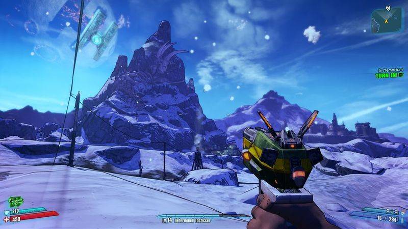

Here's a few images that might help.

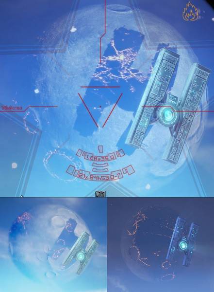

Here you can see the volcanic activity clearly under a number of conditions. The H-shaped space station is, of course, not a natural feature, and though it is pretty dang big, it's apparent size and distance are both highly deceptive.
The "craters" are not actually natural features either, as this view from the station itself shows: The circular formations were left by an alien civilization that is now virtually extinct. They used Pandora and Elpis as a dumping ground for dangerous alien superweapons, including monstrous creatures that were sealed away in stasis. No telling what effect the aliens and monsters had on the planet's development, so it's probably best to assume no influence beyond what's readily apparent.

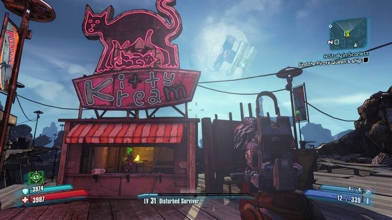

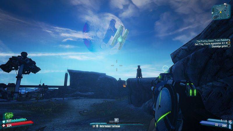

And here's a view of Pandora from Elpis

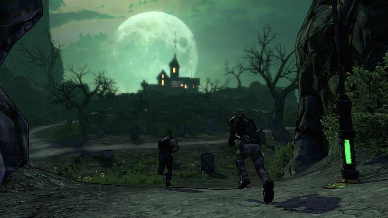

Finally, here's a view of the sky from different regions, and a brief rundown of the climate:
Never actually gets "day," only seems to ever be twilight. This is the region during the previous cycle (note lack of Helios Station). No telling what it looks like now.A very strange biome. Very wet and swampy, clouds blanketing the sky most of the time. The sun is barely visible on the horizon, but looking in that direction at all it's blindingly bright, even through the cloud cover. The moon is...I need to reinstall it and check, but IIRC it's rarely visible and lower in the horizon than the previous biome. Also, much of it takes place in a vast cavern with a very high ceiling and the sunward side completely open. Waterfalls come from cracks in the ceiling.
Giant monster notwithstanding, this is the most hospitable biome observed. Subtropical with liquid seas. Presumably, what the desert looked like last cycle.
Completely dry desert region. Was coastal and tropical last cycle, now the oceans are dry. I thought I'd show two views so the hint of sun on one horizon and the location of the moon were both visible.
Finally, the moon in the arctic areas. Note how the sky is much dimmer even in lunar day than in the desert regions. Also, there seems to be an aurora here at night.
