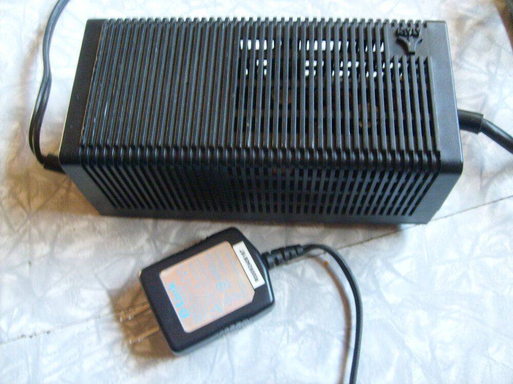

I suspect LC filters of 150hz are large, heavy, expensive and energy consuming compared to a PWM circuit of the same power.
Not an exact comparison, but here is an old 16W transformer power supply (1172 grams) and modern 12.5W switching supply (70 grams).

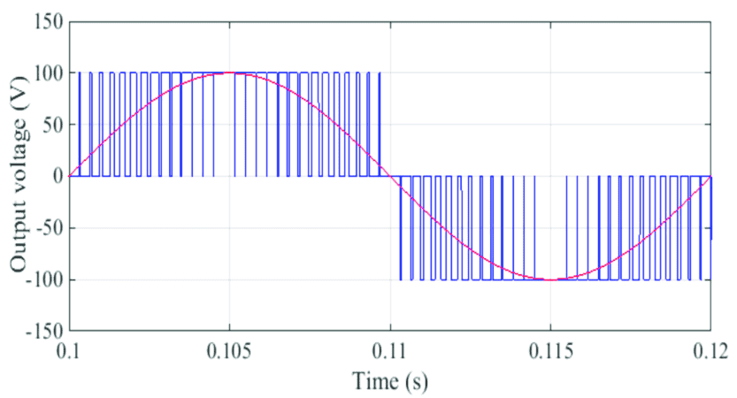

basically, it's this PWM output waveform that i am particularly interested in:
some papers cite this as the "idealized" dc output of an inverter. this PWM has a varied duty cycle over time, but there are points of symmetry. I'm curious as to what this PWM output's harmonic content looks like, and whether it really does get rid of harmonics better than a plain old 50% duty cycle square wave.
1. The DC input voltage to the inverter is not fixed and can vary widely over each cycle.
2. The AC output load on the inverter can change rapidly within each cycle.
The PWM output can respond to both of those changes, and it can do it several hundred times in each cycle.
It is the exact same thing I am referring to.
Yes it does. Been there, done that.
Is that because the duty cycle can be varied / regulated over the cycle?
Yes. The sinusoidal theoretical PWM plotted in blue (post #9), is into an ideal load. But the PW is not predetermined, the PWM must be "lively", as it handles the real changes in real time through an error amplifier and feedback loop.
Or to put it another way...
The PWM switch with a LPF, is an efficient “energy flow throttle” that links the unregulated DC input voltage, to the unspecified load current, (with load harmonics).
The PWM switches to maintain close to a sinusoidal output voltage, independent of the variation of both the input voltage, and the output load current.
Generating a 50 Hz voltage waveform through a 10 kHz PWM gives 200 corrections per cycle. That is 50 corrections per quadrant. Each correction matches the changing DC voltage on the DC link reservoir capacitor, to the output current drawn by the load from the sinewave voltage.
A filtered 50 Hz square wave would have an amplitude dependent on the average DC input voltage. A filtered 50 Hz square wave could not produce the harmonic output currents, required by the arbitrary reactive nature of the load, without significant distortion of the output sinewave. The mass of the resonant 50 Hz filter, needed to store energy for the next cycle would be huge. The LPF for a 10 kHz PWM is much smaller and can change more rapidly.

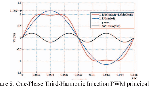

PWM generation of Sinewaves using that method is not as efficient as possible because the peak voltage of the sine is equal to the DC supply. What we want is to make the sine RMS value close to the DC supply. For three phase inverters the simple method for that is third harmonic injection of each voltage leg. We use PWM to generate this waveform that looks like a square-wave because we use harmonics to our advantage.
With proper injection on all three legs the sine output voltage looks like this across the legs.
The peaks are higher than the DC supply.
Low pass filtered signals from a motor control demo using a 32-bit controller for waveform generation using PWM @ 20kHz for a sinewave of only a few Hz at the most. The high radio of carrier to signal frequency makes the filter design much easier. The center trace is the scope math function of difference between two sources.
3-phase Space Vector PWM generated from the controller before filter.

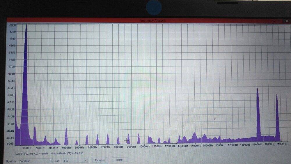

I'd like to share a pic I snapped of the screen on my computer a while back that relates to this subject. What you are looking at is a pic shot from my cell phone of a spectral display from the program audacity running on the laptop. I wanted to show this to a friend so the quick shot with the cell phone cam was the easiest way to do it. I was generating a sine wave around 800 hertz with a sample rate of around 20 KHz. D/A convertor was an 8 bit convertor. Very simple R2R ladder. All done on a microcontroller. I simply fed this signal into the mic jack on the laptop after it was padded down to an appropriate level. No filtering. So the laptop got all the square-like steps that a sampled sine wave would have. Notice the fundamental frequency around 800 hertz. Also there are harmonics down a fair ways that go on up the spectrum. Now the big deal I want to make here is the two signals either side of the sampling frequency that are spaced by 800 * 2. This is what a PWM signal will look very similar to. Imagine filtering out the signals that are around 20 KHz while keeping the signals we want that in this case can be anything that is between 300 hertz and 3000 hertz. Very easy to do.
Now imagine starting out with a square wave as the fundamental and trying to filter out everything we don't want starting with the second harmonic of the fundamental which in this case could be as low as 300 hertz. Keep in mind that THOSE harmonics will be much higher in amplitude than the ones shown in this spectral display. Now suppose we want to synthesize a signal at 800 hertz. We need to now switch in a different filter because what is appropriate as a filter when we want 300 hertz is no longer appropriate when generating 800 hertz.
