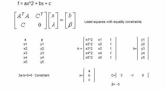

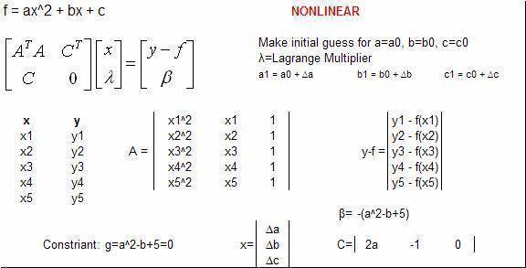

jkristoff said:
I am trying your first-reply suggestion using matrices in excel, but having trouble so far. How did you include the equality constraint?
The answer depends on how much you know about least squares. If you know how to derive the 'normal' equations associated with linear least squares, adding equality constraints is just an extension by using Langrange Multipliers to alter the equation being minimized. Your case is more complicated because the constraint is nonlinear. Thus, the solution is iterative by guessing at the initial values of the unknowns, solving a 'linearlized' set of equations (including the linearized constraint equations), updating the values of the unknowns, and iterating until desired convergence is achieved.
The attachments shows the linear and nonlinear situations.
