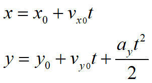

In A system:
In B system:

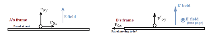

Is this the correct setup of the problem at the moment the particle is launched?
A's frame is the unprimed frame and B's frame is the primed frame.

TSny said:
The resolution of the paradox involves relativity.
Yes it is the setup.

The magnetic force in B's frame will give the particle a nonzero x-component of acceleration. Does the particle also have a nonzero x-component of acceleration in A's frame where there is no x-component of force? You can answer that by considering the relativistic formula for the x-component of momentum.

In A's frame, the only force is the electric force, qE, in the y direction. There is no magnetic field in A's frame.
So, the x-component of force is zero in frame A.
The key is to recall whether force in relativity is equal to rate of change of momentum or equal to mass times acceleration.

In frame A the x-component of the force is zero. This means that the x-component of momentum is constant. But that implies that the x-component of velocity decreases in this situation where the particle’s y- component of velocity increases. To see why, look at the formula for the x-component of momentum. It involves both the x- and y- components of velocity.

Yes, that's right. If Vx0 = 0 and if there is no x-component of force, then Vx and Px will remain zero. But in A's frame, Vx0 is not zero.
According to A, Vx must decrease in order to maintain a constant x-component of momentum. This sounds paradoxical at first, until you examine carefully the formula for the x-component of relativistic momentum. Note, that if you use the concept of relativistic mass: mr = m/(1-V2/c2)1/2, then you can write the x-component of momentum as
Px = mrVx.
As the particle pick up speed in the y-direction due to the electric force, what happens to the relativistic mass? So, what must happen to Vx in order for Px to remain constant? (Remember, in A's frame there is no force acting on the particle in the x direction. So, in A's frame Px is constant.)
In B's frame, V'x0 = 0. As time passes according to B, V'x will decrease (become more and more negative) due to the magnetic force acting in the negative x direction.
Both frames agree that the particle has nonzero x-component of acceleration. (But, they will disagree on the numerical value of the acceleration.)
