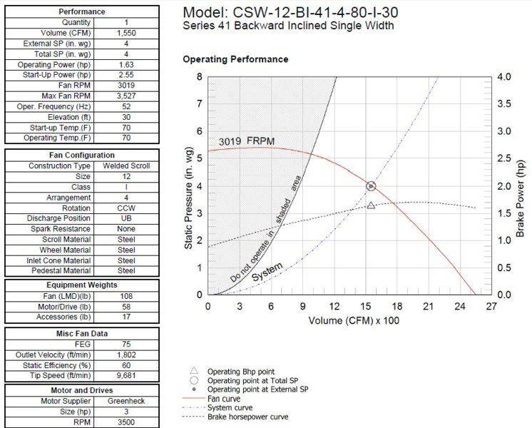

As best as I can tell, this is a scenario like the OP describes. Here is a random fan curve:
If not connected to a system, the fan is allowed to free-blow, and the fan curve tells us the airflow is 2550 CFM, or a velocity of 3072 fpm.
However, the outlet velocity in the selected configuration is 1802 fpm (1550 CFM) and the static pressure 4.0" w.g. Velocity pressure is often ignored when it is a small fraction of static pressure, but in this case it is 0.2". If the only thing attached to this fan is a nozzle, a nozzle ratio of 4.55:1 will provide a final velocity of 8208 fpm, using up all that 4.2" of available total pressure (outlet static pressure is 0/atmospheric).
  • This is how Bernoulli's principle/the Venturi effect works, for incompressible flow, with no losses.
  • This is how real fans work.
Note, @.Scott in this case the fan is turned by a 3-phase motor and the rpm is fixed. For some motors/fans, the rpm will drop if you add a nozzle, as you said.

If I may, I would like to try to reach some conclusions for this thread, and please correct me if I am wrong.
Conclusion 1. When a convergent nozzle is attached to a fan driven by an electric motor it is impossible due to the back pressure generated by the nozzle for the kinetic power of the airflow at the nozzle exit to be greater than the motor power.
Conclusion 2. If a convergent nozzle is used to accelerate wind before applying it to a wind turbine, the kinetic power of the wind flow at the exit of the nozzle will always be greater than the kinetic power of the wind flow at the inlet of the nozzle. As an example, if a 2:1 ratio convergence nozzle is used, the outlet kinetic power will be exactly 4 times greater than the inlet kinetic power.
For both conclusions, it is assumed that the flow is inviscid, incompressible, steady and horizontal. In addition, by kinetic power it is meant the following physical quantity:(1/2) times (cross-sectional area seen by airflow) times (velocity of the airflow at such area to the cubic power). In other words, kinetic power of a flow is simply its kinetic energy per unit time.
Looks good to me, although I didn’t check the math on that last part.
