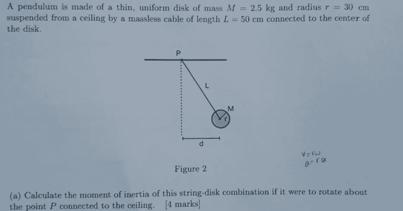

I=1/2mr^2 for a disk
I=Icom + md^2
Using the trivial way, you get I = M(r+L)^2. This is definitely correct.
Out of curiosity, can the parallel axis theorem be applied here? I took the axis of rotation to be into the page, then calculated the moment of inertia for the disk, which is I = 1/2Mr^2. Next, I calculated the distance from the centre of the bob to P, which is r+L. So the moment of inertia "should" be I = 1/2MR^2 + M(r+L)^2, which contradicts my previous answer.
Why is the parallel axis theorem not applicable here?

laser said:
As the disk is symmetrical we can say that all of its mass acts through its centre of mass.
The distance from P to its centre of mass is L + d.
Is this not correct?
That's not correct. The simplest proof (that it's not correct) in this case is to apply the parallel axis theorem!

It wasn't the "d" that was the problem. You disproved your own statement yourself in the original post by applying the parallel axis theorem.
Ah okay. I thought that there was a problem in the parallel axis theorem proof, some limitation to it that I was missing.
On the other hand, why is M(L+r)^2 wrong? The definition of moment of inertia is the integral of y^2 dm. Because we can say that it's a point particle (symmetrical disk), y is constant. And the integral of dm is just M.
(y = L + r)
It's not wrong, it's an approximation in the limit ##L>>r.##

@laser, if you haven't yet understood your mistake, here’s a little moment of inertia (MoI) exercise that should help.
P . . . . . . A-B
Point mass A = 1kg and distance PA =10m.
Point mass B = 1kg and distance PB =12m.
A and B are connected by a rod (length 2m) of negligible mass.
1. What is A’s MoI about P?
2. What is B’s MoI about P?
3. What is the total MoI about P (of the obect consisting of A, B and rod)?
4. What is the MoI about P of a 2kg point mass a distance 11m from P?
Compare your answers to 3 and 4 and think about why they are different.

Just realised I messed up my notations... I was taking L to be P to nearest, so closest is L and farthest is L+2r. And the question says L is to the centre to P...
Regardless, let me get this straight. You cannot say that the disk is a point particle with all its mass acting through its centre of mass?
Because the disk is symmetrical though, wouldn't the integral just be L^2? (L is what I previously called L+r, let's just say it's the distance from the centre of mass to P.)
To give an analogy (I hope I haven't carried this misconception with me for several years :D), when doing Newton's law of gravitation with planets, we take "r" in F=Gmm/r^2 to be the distance from its centre of mass, because even though you have to do an integral will all the dm, because Earth is "basically a sphere", we can say that all its mass acts on its centre of mass. Is this also incorrect?
Just forget about the pendulum for a moment, if you could collapse the disk to a point, what would be its MOI through its center of mass?

OHH, it's the square, isn't it? 10^2 and 12^2 is not the same as 2*11^2
Likes Steve4Physics
No. The integral is on the form:
\int_{a-r}^{a+r} f(y) y^2 dy
where ##f(y)## is symmetric around ##y=a## (actually it is not, but it is to first approximation). However, ##y^2## is not linear so you cannot use the symmetry argument to just take the value at ##a##.

laser said:
The distance from P to its centre of mass is L + r.
Carefully read the wording of the problem.
There are 50 cm separating P from the center of the disc.
How the 60 cm diameter thin disc can remain vertical and not turning around the string, I don't know. :rolleyes:
Likes Orodruin and laser
I am mystified by this thread. The question clearly states that L is the distance from P to the centre of the disc, yet so many seem to have read it as the distance to the circumference.
But I see no discussion of how exactly the disc is moving. If only held by a wire at its centre (a loop of wire passing through the centre, say), with no friction between string and disc, it is unlikely to rotate on its own axis. So no parallel axis theorem needed: it can be reduced to a point mass, leading to ##mL^2##.
On the other hand, part (a) says the string-disc combination is rotating about point P, which suggests the combination moves as a rigid body. Maybe the string is stuck to the sides of the disc.

The length of the cable is 50cm, the radius of the disk is 30 cm. Why do the setters of such questions provide such hopelessly out of scale diagrams?
Likes SammyS and Lnewqban
So that you don't arrive at the right answer by invalidly inferring some geometric relationship from the diagram? Nah, it's because the diagram was recycled with different parameters and the setter could not be bothered drawing a new one.
