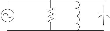

I think you started out OK with the 0.6 PF portion except that what you call Xc is actual inductive or Xl. Nonetheless, your Z1 reflects this result.
I like to keep a circuit diagram in mind, like the following
I also like to work with the power quantities rather than impedances.
So you start off with 50 kW and that doesn't change for the resistive portion.
Initial apparent power is 50/0.6 or 83.3 kVA and the reactive power is 50/0.6 * 0.8 or 66.7 kvar.When you get to the 0.9 pf situation, the resistive or 50 kW portion doesn't change so the new reactive power is 50/0.9 * 0.436 or 42.5 kvar inductive.
To achieve the reduction in kvar from 66.7 to 42.5 kvar, we add parallel capacitance. So the capacitance required must make up the difference of 22.2 kvar. With your 10 kV voltage source, what capacitance is required to give you 22.2 kvar? I'm not sure it is the same answer that you showed but I haven't checked that yet.

Look at @magoo's schematic.
That shows capacitance in parallel with the load resistance. You calculated the entire current as flowing through the resistor as if the load's capacitance was in series with the resistor.

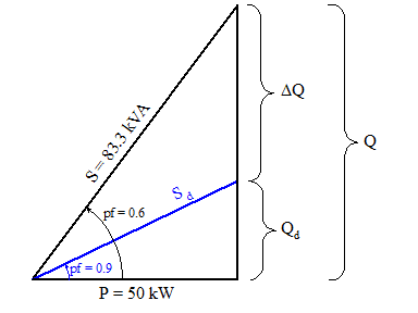

I think that some values are getting mixed up. Can we agree that for the original circuit that the apparent power is correctly calculated to be ##S = 83.33\;kVA##, and that the reactive power is ##Q = 66.67\;kVAr##?
Then, taking the pf = 0.9 case we look to find the desired reactive power ##Q_d##.
##S_d = \frac{P}{0.9} = 55.56\;kVA## {The apparent power for the pf 0.9 case}
##Q_d = \sqrt{S_d^2 - P^2} = 24.23\;kVAr##
In the following diagram is the situation laid out in the form of power triangles:
The ##\Delta Q## is what the what the added capacitance will need to "consume".
##\Delta Q = Q - Q_d = 42.45\;kVAr##
So your "other sources" have it right.

@gneill Thanks for that very thorough explanation, definitely one of those moments when it just clicks now.
So 'rerunning' the calc.
Xc = V / Qc = 10000^2 / 42450 = 2355.712Ω C = 1/ (2πfXc) = 1 / 2*π*60*2355.712 = 1.126μF
The help is much appreciated! Also thank you @magoo & @anorlunda .
