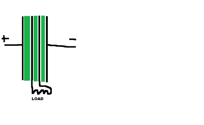

HiI’ve been reading for a while and decided to ask , suppose we have a parallel plate capacitor with a distance x between the plates , in between the plates are another two plates with a dielectric so in total 4 plates. The outer two are attached to a dc supply of 12volts for example.
Now I understand that charge on the plates is given by their separation distance , surface area and the dielectric between them , what I don’t know for sure is what happens in the middle two plates in my example that are not attached to a power source ,
They will get charge on them as well I suppose and the dielectric in the middle will get polarized two , as far as I understand inserting such two plates in the middle is effectively putting another capacitor in series.
I want to know what happens on the two plates in the middle of the outer two which are attached to DC. I suppose the inner plates mimic the outer ones in terms of charge separation and + and – sides just that the charge on them is weaker because they are at a distance away?What would happen if I removed the inner plates with their dielectric , would they hold their charge just like any other parallel plate cap that has been charged , I suppose they should.My final question for now is this , what happens when I have my 4 plates , outer ones attached to DC , inner ones floating , now I charge the cap , then I connect a load like a light bulb between the inner ones , would the lightbulb flash as the charge flows through the load from plate to plate , and what would happen afterwards when my outer plates are still connected to DC but the inner ones have been attached to a load?

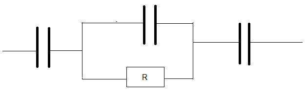

This is an equivalent diagram:
If you freshly connect the battery to the circuit, you will have some voltage in the middle capacitor, which then discharges via the resistor/lamp/other load, and after a while the middle capacitor is uncharged.
The light bulb would flash since the two inner plates are at different potentials. But the load would eventually equalize the potential across the inner plates thus producing a different capacitance one of two capacitors in series with capacitance defined by separations of x/3 or ε02A/3x resulting in a new charge on the outer plates.

I wonder could someone explain me in a step by step way what happens in this scenario that I will write down here , I sort of know myself but some things confuse me. Here goes.The same 4 plate parallel capacitor just that in this example the outer plates are stationary and they have a dielectric on each inner side to increase capacitance , but the inner plates that also have a dielectric between them are on a rotating axis and are capable of being either put fully in between the outer plates forming a 4 plate cap or they can be rotated out from the outer plates leaving just the two outer plates and an air gap.
Now I wonder what happens here , the inner plates that are fixed on a rotating axis have a load attached to them , say I first connect the outer plates to a certain DC voltage they charge up, then I introduce the inner plates by rotating them in between, what happens now ? The inner plates and the dielectric get polarized and they charge up , does it require extra force for me to rotate the plates in between the outer ones or is no force exerted on the rotational movement as the plates slide in just except for some pure mechanical losses in bearings ?
As I rotate the inner plates in , they charge up but if the load is constantly attached to them does the load experience some current through it while the plates are trying to charge up ? For example the lightbulb that is attached to those inner plates , does it flash?And my final one for now , if the inner plate do get some charge even with a load attached to them , the charge gets used up through the load , then as I move the plates out rotate them around and move them in once again will the same cycle repeat , will they get charged again ?
I ask this because I understand how a capacitor can transfer energy when AC is attached to it’s plates , since the voltage/current is changing , but I wonder is there any case where DC can transfer some energy and how does it happen , that is why I made up this thought experiment with the inner two plates floating and not attached to anything and how they charge up and what happens to that charge and if indeed that charge can be used for a load then how did the energy transferred from the outer plates which had a static DC load on them to the inner ones which are inserted in between and polarized.
First assume there is no load connected across the iinner plates in this case no force is required because a capacitor by virtue of the fringe field exerts a force on a dipole thus tending to pull the dipoles in the dielectric into it. This force results from the field gradient in the fringe field.. See an intermediate EM text.
Now as the dielectric is pulled into the space between the two outer plates the capacitance begins to decrease thus lowering the energy stored in the capacitor. you can see this by calculating the capacitance of a capacitor with 1/3 of the dielectric removed and comparing that to the capacitance of effectively three identical capacitors connected in series each with the dielectric but only 1/3 the thickness.
Attaching a load should have an affect in general . However if the inner plates are introduced slowly so as the difference in potential of the plates can be equalized quickly then nothing should happen the capacitance of the system will not change and there should not be any fringe field between these plates which could cause a pulling force. I guess you could say that the plates shield the dielectric between the inner plates from the outer plates field and cannot polarize the dielectric.
If the inner plates are introduced much faster than the time constant of the load and inner plate configuration then the plates will have a potential difference for a time and charge must flow from the high to the low potential plate until the difference is zero. Now there is no net charge on these inner plates at any time but the potential difference will move charge from one plate to the other until the potential difference is zero. When the plates are removed the plates will have unequal charges on them so a current will flow again to equalize the potential difference outside of the outer plates. These inner plate sort of act like a battery in that there is no net charge but a potential difference.
