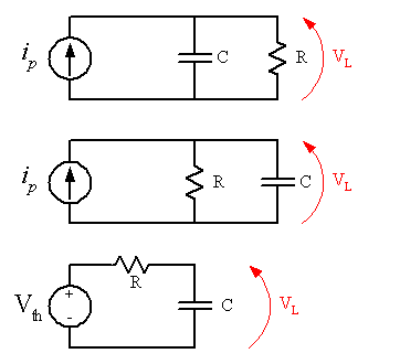

An accelerometer is connected via a length of coaxial cable to an amplifier. The arrangement is modeled by:
(a) a Norton generator in parallel with a capacitor (CP) representing the piezoelectric crystal within the accelerometer;
(b) a lumped capacitor (CC) representing the coaxial cable; and
(c) a load (RL) representing the amplifier.
See attached for circuit diagram.
The current generated by the accelerometer (iP) is proportional to the rate of displacement of the piezoelectric crystal. Hence iP = K dx/dt. In laplace form iP(s) = KsΔx(s).
(1) Derive an expression for the laplace transfer function T(s) = ΔvL(s) / ΔiP(s).(2) Express ΔvL as a function of time (i.e. the transient response of the voltage ΔvL ) when iP is subject to a step change.(3) Using the values given in TABLE A, estimate the time taken for the voltage vL to reach its steady state value if the current iP is subject to a step change of 2 nA.
CP=1400 pF
CC=250 pF
RL=5 MΩ
TABLE A
Q(1).
I believe (based on internet research) that after redrawing the circuit with an equivalent single parallel capacitor, C, that the answer is
ΔvL(s) / ΔiP(s) = R / 1+sRC
However, I’m struggling with the derivation. In time-domain vL = iPR(1-e^-t/CR). But when I inverse laplace transform R / 1+sRC I get 1/C(1-e^-t/CR). I don’t understand how I can replace R with 1/C in the time-domain. Can anyone help?Q(2).
vL(t) = iPR(1-e^-t/CR).Q(3).
C = CP+CC = 1400*10^-12 + 250*10^-12 = 1.65*10^-9
Time for vL to reach steady state = 5CR = 5*5*10^6*1.65*10^-9 = 41.25*10^-3 s
However, if this is correct the magnitude of the step current is irrelevant to the steady state time for vL. Since the problem specifies a step current of 2nA I’m wary of dismissing this variable as irrelevant. Am I missing something?
Any help with the above would be greatly appreciated.

First find the transfer function for ##\frac{v_L}{i_P}##. Begin by replacing the components with their Laplace domain equivalents (you can combine the capacitors into a single component first). Then consider how one differentiates in the Laplace domain.

So you have a resistor and a capacitor in parallel with a current source. The derivation can be done by writing a KCL at the positive node. solve that with algebra and you will get the correct answer.

Ok, derivation of the answer to Q(1) as follows:
Vin = Ip * Req
where
Vin is the input voltage;
Ip is the source current (from the piezoelectric crystal);
Req is the equivalent resistance of the parallel capacitor and load
In the s-domain:
Vin(s) = Ip(s) * Req(s)
therefore
Vin(s) / Ip(s) = Req(s) = (Rc*Rl)/(Rc+Rl) = [(1/sC)*Rl] / [(1/sC)+Rl] = Rl/sC / 1/sC +Rl = R / 1+sCRl
where
Rc is the resistance of the capacitor = 1/sC in the s-domain
Rl is the resistance of the load.

The derivation is as follows:
Applying KCL to the positive node:
Ip = Ic + Ir
where Ip is the circuit current, Ic is the current through the capacitor and Ir is current through the load
therefore
Ip(t) = V(t)/R + C*(dV(t)/dt)
Laplace transform of the above:
Ip(s) / s = V(s)/R + sCV(s)
therefore
V(s) = Ip(s) / s(sC+1/R) = Ip(s)*R* [ (1/s) - 1/(s+1/CR) ]
Inverse laplace transform of last form of the equation above:
V(t) = Ip(t)*R*(1-e^(-t/CR))
Does my answer to Q(2) now look acceptable in light of the above explanation?
ahhh my apologies. You are correct. I forgot to add 1/s for the step function. I guess that's what happens why you try to help people solve problems without thinking!

I'm struggling to see how u have calculated 'Ip(s)*R* [ (1/s) - 1/(s+1/CR) ]' from the step prior to this?
I have tried all sorts multiplying out the denominator, rearranging the formula..
Hint: Partial Fractions.
ok thanks,
Am I on the right track with ip(s)/s(sc + /r) = A/s + Bs+C/(sc + 1/r)
It'll be more straightforward to just work with the necessary portion that you want to use partial fraction on.
You start with: V(s) = Ip(s) / s(sC+1/R). Multiply though the top and bottom of the RHS by R to get:
##Vp(s) = Ip(s) R \frac{1}{s(1 + s R C)}##
Forget the Ip(s)R bit for now and work with the fraction part:
##\frac{1}{s(1 + s R C)} = ?##
1/s - 1/s+1/rc
MattSiemens said:
1/s - 1/s+1/rc
I think you need more parentheses to make the order of operations clear, else it's most definitely incorrect :smile:
Opps..
1/s - 1/(s+(1/rc))
Thanks a lot! This was so frustrating as I new the answer was of a first order differential just couldn't get to it!
