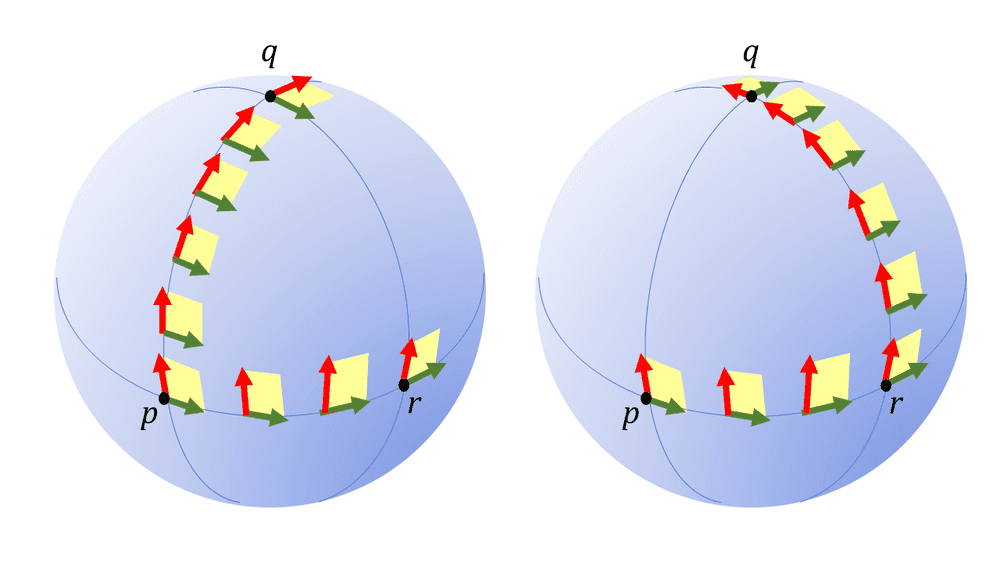

It's easier to consider an example of a curved 2D space instead of a curved 4D spacetime, so consider the 2D surface of a sphere. The advantage is that we can draw diagrams of the 2D space embedded in 3D Euclidean space. The third dimension is never used in the maths but it can help you visualise what is happening.
Below we have a blue 2D manifold. The yellow squares represent 2D tangent spaces at various points on the manifold and the red and green arrows represent a choice for the two basis vectors for each tangent space.
The left diagram shows basis vectors that have been parallel-transported from a point ##p## along two different paths.
The right diagram shows basis vectors that have been parallel-transported from another point ##r## along two different paths.
And what is clear is that both diagrams agree over the basis vectors at ##p## and ##r##, but they disagree over the basis vectors at ##q##.
It also shows that parallel transport direct from ##p## to ##q## is not the same as parallel transport from ##p## to ##r## to ##q##.

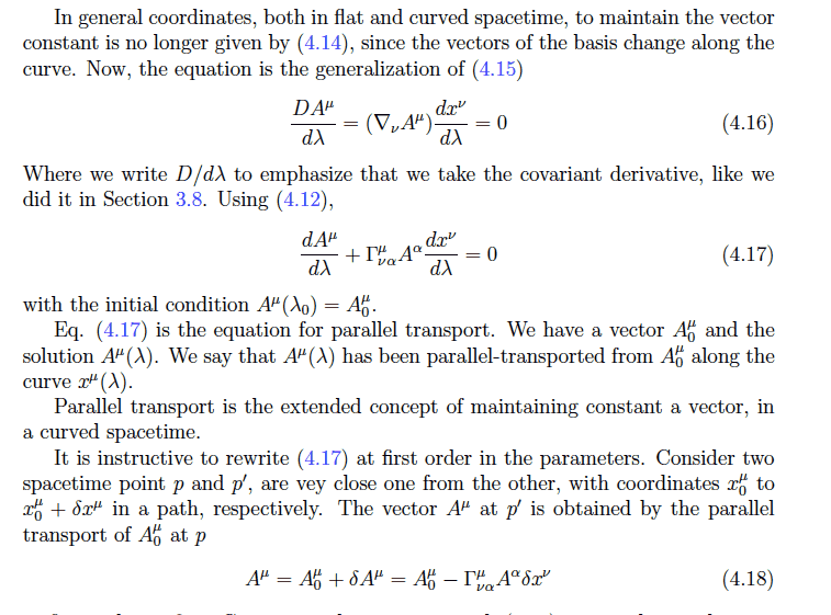

I am sorry guys but I definitely don't get it. In the sphere example, which I have seen everywhere, I don't know which is the rule to choose the local reference frame at a certain point of the curve. In the beginning it seems that the basis vectors chosen are the ones corresponding to the azimuth angle and the polar angle. This makes sense to me, because these two vectors do change along the curve chosen in such a way that in order to keep some vector (in the abstract physical sense) constant their components must change at every point. Nevertheless, when arriving to the north pole this basis vectors are no longer well defined, since it is a singular point.
I will try to make my question as simple as possible:
Let us consider the physical quantity ##A^{\mu}(x^{\nu}_0) e^\alpha_{\mu}(x^\nu_0)## which it is obtained by evaluating the vectorial field ##A^{\mu}(x^{\nu})## at ##x^\nu_0##, considering a local reference frame defined by the basis vectors ##e^\alpha_{\mu}(x^\nu_0)##. This basis vectors, in contrast with the coordinates ##A^{\mu}(x^{\nu}_0)##, reffer to an actual physical quantity and, therefore, do not depend on the reference frame chosen.
If we perform a parallel transport of this vector from ##x^{\nu}_0## to ##y^{\nu}_0## we obtain ## \hat{A}^{\mu}(y^{\nu}_0) ## which satisfies the following:
$$ \hat{A}^{\mu}(y^{\nu}_0) e^\alpha_{\mu}(y^\nu_0) = A^{\mu}(x^{\nu}_0) e^\alpha_{\mu}(x^\nu_0) $$
My only question is how do we know the relation between the basis vectors ##e_{\mu}(y^\nu_0)## and ##e^\alpha_{\mu}(x^\nu_0)##. Because it seems that they don't just depend on the position considered but also on the path we have followed to reach that position. I am asking for the rule we follow to choose the basis vectors at every single point of the curve, which ultimately determines how do the components of the vector transported must vary.
Someone might say that there is no way of relating ##e^\alpha_{\mu}(y^\nu_0)## and ##e^\alpha_{\mu}(x^\nu_0)## since they are vectors referred to different locations and therefore different local frames. But I don't see this clear, since ##e^\alpha_{\mu}(y^\nu_0)## and ##e^\alpha_{\mu}(x^\nu_0)## are actual physical quantities i.e. they do not depend of the reference frame considered. In the sphere example, for instance, the basis vectors are all 3-D vectors which can be related considering theme as free vectors, independently of their position.

What you should be looking at here is the inner product between the two vectors ##A## and ##e^\alpha##, which is what the expression you wrote down represents. If we assume that ##e^\alpha## is the tangent vector to the curve you want to transport along, then the inner product between ##A## and ##e^\alpha## tells you the angle of ##A## relative to the direction along the curve. And parallel transport will keep that angle the same as both vectors get transported along the curve (assuming the curve is a geodesic). That is a key geometric property that you need to understand.
Now, consider the sphere example again. Suppose we start out at point p on the equator, with the vector ##A## pointing towards the North Pole, which is along the first geodesic segment we want to parallel transport along. Then ##A \cdot e^\alpha = 1## at p (assuming both vectors are unit vectors), and that property will be preserved by parallel transport, so when we reach the North Pole, we will have ##\tilde{A} \cdot \tilde{e}^\alpha = 1##, i.e., the parallel transported vectors will still point in the same direction.
Now we switch curves, which may be where some of your confusion is happening. Our second curve segment is at right angles to the first, so it has a different tangent vector, ##e^\beta##, which makes a different angle with our chosen vector ##A## than ##e^\alpha## did. In fact, since the curve is at right angles to our original one, we will have ##\tilde{A} \cdot e^\beta = 0##. Notice that this statement, just like the statement that ##A \cdot e^\alpha = 1##, has nothing to do with any choice of basis at the North Pole. The key point is not that any basis has changed, it's that we've changed curves, so the tangent vector has changed, so the angle between the tangent vector and ##A## has changed.
Now we transport along our second curve back down to the equator; call the point we reach on the equator point q. Parallel transport will preserve ##\tilde{A} \cdot e^\beta = 0##, so that will still be true at q. At q, we switch curves once more, our third curve being the equator, so we have a third new tangent vector, ##e^\gamma##, at right angles to ##e^\beta##, and therefore we have ##\tilde{A} \cdot e^\gamma = -1##. We then transport along the equator back to point p. And we find that the transported vector ##A## is now at right angles to the original vector ##e^\alpha##: we have ##\tilde{A} \cdot e^\alpha = 0##. Or, since the original vector ##A## pointed in the same direction as ##e^\alpha##, we can say that parallel transporting around the closed curve has changed the vector ##A## by a right angle; the inner product of the transported vector with the original vector vanishes: ##tilde{A} \cdot A = 0##. And note, once again, that I reached this conclusion without talking at all about any coordinates or reference frames or basis vectors. I only talked about invariant geometric properties: tangent vectors to curves and inner products of vectors.
So you are telling me that parallel transport of a vector ##A^\mu## along a curve ##x^\mu(\lambda)## fulfills the following
$$ \frac{d}{d\lambda}\Big( \frac{d x^\nu(\lambda)}{d\lambda}\tilde{A}(x(\lambda))_\nu\Big) = \frac{d}{d\lambda} \Big(\tilde{A}(\lambda) \cdot t(\lambda) \Big) = 0 $$
i.e. the inner product of the vector tangent to the curve ##t^\nu =\frac{d x^\nu(\lambda)}{d\lambda} ## and the transported vector ## \tilde{A}^\nu ## remains constant along the curve.
Nevertheless, the condition I found that a parallel transported vector ##\tilde{A}^\mu## must fulfill is:
$$ \frac{D}{d\lambda}\tilde{A}(x(\lambda))^\mu = \big(\nabla_\nu \tilde{A}(x(\lambda))^\mu\big)\frac{dx^\nu}{d\lambda} = 0 $$
Where ## \nabla_\nu \tilde{A}^\mu ## is the ##\mu##-th component of the covariant derivative of ##\tilde{A}^\mu## w.r.t. ##x^\nu##.
I don't think both conditions are equivalent. Am I using a bad definition of parallel transport? This would explain a lot of things

Apparently yes, as you were told all the way back in post #2 of this thread.
Where did you find this condition?
In the notes I was given on General relativity at my University. Here I attach both the condition and the definition of covariant derivative I was also given.
Equation 4.17 in what you gave looks like a correct equation for parallel transport in a global coordinate chart--i.e., a chart that covers the entire curve you are going to parallel transport along. It is not an equation that is useful in a local coordinate chart centered on just one point. I suspect you have been trying to think of it in the latter fashion; that doesn't work. In any case, as I and others have pointed out repeatedly now, it's best to not even think about coordinates at all until you first understand parallel transport in a coordinate-independent way.
(In a local coordinate chart, at least if it is constructed in the standard way, i.e., Riemann normal coordinates, the connection coefficients all vanish so equation 4.17 just reduces to the partial derivatives of the components all being zero. But that only works within the small patch surrounding the chosen point, and in that small patch, all effects of curvature are being ignored, so there's no way of even dealing with the kinds of scenarios we've been discussing in this thread, such as on a sphere.)
They are, it just takes a little work to show. In fact we can show something more general than what you said: we can show that parallel transport preserves the inner product of any two vectors. I.e., we can show that
\frac{d}{d \lambda} \left( A^\mu B_\mu \right) = 0
for any ##A^\mu##, ##B_\mu##. To prove it, all you need is the corresponding formula to Equation 4.17 for parallel transport when the index on the vector is "down" instead of "up":
\frac{d B_\mu}{d \lambda} - \Gamma^\alpha_{\mu \nu} B_\alpha \frac{d x^\mu}{d \lambda} = 0
Then you just use the chain rule on the LHS of the first formula above, and use Equation 4.17 and the second formula above to substitute for ##d A^\mu / d \lambda## and ##d B_\mu / d \lambda##. You should find that all of the terms cancel.

My suggestion is that you work out some simple examples in detail. For example, take a two-dimensional flat plane. Use polar coordinates ##r## and ##\theta##, which are related to rectangular coordinates ##x## and ##y## through ##x = r cos(\theta)## and ##y = r sin(\theta)##.
Start at the point ##r=1, \theta = 0## with the vector ##V## that has components ##V^r = 1##, ##V^\theta = 0##. Parallel transport it along the curve ##r = 1## (so only ##\theta## changes) to get to the point ##r=1, \theta = \pi/2##. What are the components of ##V## now?

  • #43
Equation 4.17 is the parallel transport equation as expressed in any given coordinate system. The problem seems to be that you are not applying the parallel transport equation, but instead using general statements about the parallel transport equation that do not really hold.
In normal coordinates for a given point ##p##, it holds that the Christoffel symbols are equal to zero at ##p## and therefore the parallel transport equation states that the directional derivative of the vector components in the direction of the curve are zero. However, this is only true at ##p## and not necessarily in other points of the chart. It is also not saying anything about what is going to happen when you change coordinates. The basis it refers to is implicitly the holonomic basis of the given coordinate system.
Reference frames are not required. I would not even consider them at all.
The connection defines the concept of keeping a vector fixed in direction as you move. If you move in a straight line (geodesic) then the vector will keep its orientation with respect to you. If you turn then the vector will turn the opposite direction with respect to you.
That is irrelevant. Every point on a sphere is equivalent. If you can imagine parallel transporting at any point on a sphere then you can imagine parallel transporting at the pole. Again, reference frames are not needed.
I just realized that if this is a problem then we can simply start at the north pole. Start at the north pole with a vector pointing along the prime meridian. Walk south along the prime meridian to the equator. The vector will point straight ahead on this whole path. Turn 90 degrees to the right and the vector will be pointing to your left. Walk around the equator a quarter of the way around the globe and the vector will continue pointing to your left. and then turn 90 degrees right again. The vector will now be pointing behind you. Walk back to the pole and when you arrive your vector is still behind you. Turn 90 degrees to the right once more and you are now facing the same direction you were originally facing. But now your vector is to your right, which is 90 degrees away from where it started pointing straight ahead.
