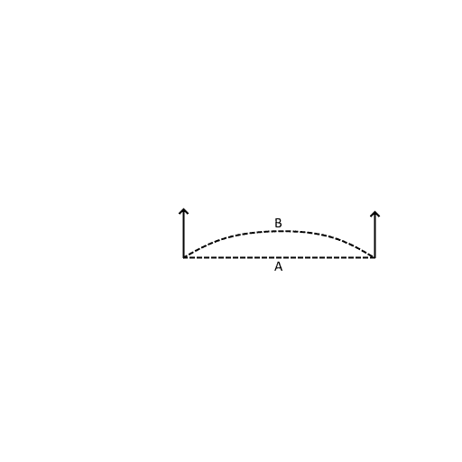

I'm not sure if the OP is still with us, but, having more time, I wanted to expand on something I said earlier. Possibly this is redundant, and the OP has already figured out the answer to their question.
In the following diagram, we are parallel transporting a vector via two different paths on a plane (the paths are represented by dotted lines, labelled A and B) from a point on the left to the point on the right.
Because we are parallel transporting on a plane, we know that the parallel-transported vector always points upwards. This won't be true in general, but by focusing on the simple case of parallel transport on the plane, we can understand the rules better.
When we parallel transport a vector, represented by a spear in the video that the OP mentioned in his original post, the angle between this vector and the path always remains constant. In the diagram, this is curve A, and the angle is always 90 degrees.
There is a formal way of saying this. The angle between the tangent vector to the curve, and the vector being parallel transported, always remains constant as we parallel transport a vector along a geodesic.
This is always true, in flat or in curved space-time. When you parallel transport a vector along a geodesic, the angle between the vector and the curve it's being transported along (technically, we say the angle between the vector and the tangent to the curve) remains constant.
Parallel transporting a vector along a geodesic using this rule is one of the easiest cases to describe, and I think the video described parallel transport in this manner, i.e. it tells you how to parallel transport a vector along a "straight" path, aka a geodesic. But it skips over the describe how to parallel transport a vector along a curved path, such as path B. THis is logical, the video doesn't need to consider any other case to make their point.
We can note, instantly, that the angle between the vector (modeled as a carried spear in the video) and the path does NOT stay constant in case B. So, we need a different rule to define parallel transport a vector along a curve that is not geodesic than the "constant angle" rule.
So, what is the rule for parallel transporting a vector along a curved path? Well, we can approximate the curved path by a number of straight line segments.
Then the angle between the vector and each of the segments remains constant as long as we are on that segment. But when we change from one segment to the next, the angle changes. By considering the limiting process where we approximate the curve as a large number of straight segments, we can carry out the process.
The video, though, doesn't consider this case. It doesn't need to to make the point the video makes - which is to say that when we parallel a transport a vector along a spherical triangle made up of three great circles, it comes back rotated.
The case of parallel transporting a vector a long a path that is not a great circle is not covered by the video, as it's not relevant to the point the video is trying to make. But we can make a good informal argument as to how to carry out parallel transport along a general curve by approximating the general curve by an ever-increasing number of segements, and taking the limit as the number of segments approaches infinity.
As an alternative, as I mentioned previously, we can use the geometric construction known as Schild's ladder to do the parallel transport. The end goal of both argumetns is to demonstrate the existence and unqiueness of this process we call "parallel transport", and to build up some intuition.
