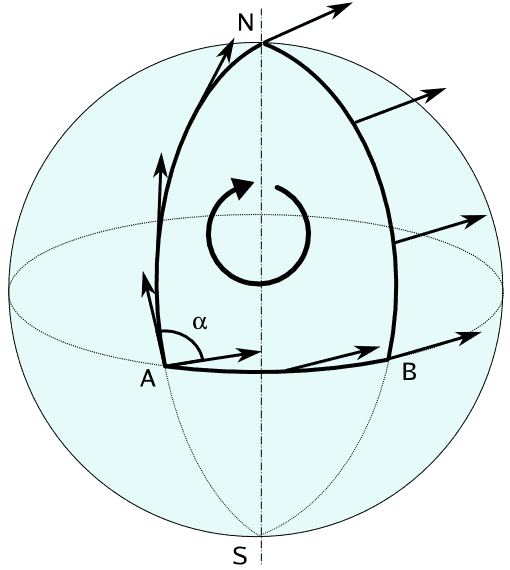

Thanks. Please help me out with this. In the path 1 it seems arrows are drawn tangential to the surface. So, initially what was pointing right points downwards by the time it reaches end of segment 1. During the segment 2 the arrow doesn't change direction and reaches starting point of 3 still pointing downwards. From then on it again moves up tangentially along the path.
Should the vector move parallel to itself, in segments 1 and 3, it doesn't look parallel to itself? The angle between successive vectors is changing.

Thanks. Here's my doubt. In the above figure the arrows are definitely parallel in the segments NB and BA. I am not able to understand why the same is not true for the segment AN?
That's because you're comparing them "across the join" at B.
Similarly, if you compare the arrows in AN and NB "across the join" at N, they are definitely parallel.
You're comparing them "across the join" at A
but A is where the journey starts (and ends), while N and B were in the middle …
in the middle, the arrows must be parallel, because that's how we decide how to move from one straight side to the next …
follow the arrow from A to N to B and back to A. :wink:

Hi, Thanks for the reply.
Can you please explain how you can tell that the vector is parallel to itself during the transport through the segment AN (I am not able to figure that out :smile:)
Yup :smile:
it starts at A, pointing along the curve
(I know it looks as if it's at about 10°, but I'm sure it's intended to be along the curve)
as it goes along AN, it stays pointing along the curve
when it reaches N, it's still pointing in the direction in which segment AN would continue, ie about 90° to segment NB
At that point, however, we start moving the arrow along the new segemnt …
but it's the same arrow, so it starts at 90° to the new segment (NM), and carries on at 90° to NB until it gets to B
(and at that point it's at about -20° to segment BA, and it carries on at -20° to BA until it gets to A)

In the linked figure,
the arrow is approximately parallel to segments AN and BA and roughly at right angles to path NB. The idea is to keep the arrow parallel to itself rather than parallel to the path. Imagine having two arrows and an assistant. The assistant goes ahead and his places his arrow parallel to the first. You then leap frog your assistant and go further ahead and then place your arrow parallel to that of your assistant and so on. The trick is that the arrow is not exactly parallel with each transition, but as near to parallel as possible while remaining tangential to the surface. For example if you started at A on the equator with your arrow tangential to the surface and pointing North, if you exactly parallel transported the arrow it would be pointing directly upwards at the North pole and no longer tangential to the surface. So parallel transporting a vector is actually doing a really bad job of keeping the vector parallel :-p. Sack the transporters!

In the above figure (previous post) the vector neither seems parallel to itself nor is it keeping a constant angle with the curve. Then how is this parallel transport?
If the curve in that figure was on a flat surface then it would be wrong because the vector should always remain parallel to itself in that case, so the curve must be on a 3D surface that curves in a way that is not visible to us. The authors do not make this clear. Some authors set out to make clear complicated concepts to readers new to the subject and other authors set to show how clever they are and without any regard to the reader's better understanding. I suspect the authors of that book are the latter type or they simply assume you already understand the subject before reading it.
A better illustration of what is happening in that figure is this:
In the above figure, the vector is neither parallel to itself nor keeping a constant angle relative to the path, but it is a bit more obvious that this is due to the 3D curvature of the surface the curve is on. Remember that "parallel" transport of a vector is not really exactly parallel but as nearly parallel to itself as possible while remaining tangential to the surface as I mentioned earlier. Now if you imagine the above figure with the pretty coloured 3D surface removed so that just the curve is visible then you would have an illustration similar to the figure in the book you referenced.
The same is true if you look at the path in the image in post #14 without the 3D sphere in the background. The vector would just appear to be pointing in random directions when the 3D background surface is not visible.
