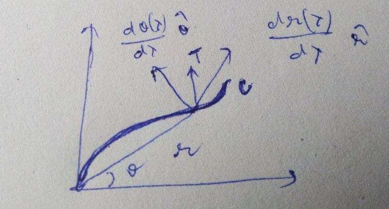

Here T (tangent vector) is not pointing along the curve??

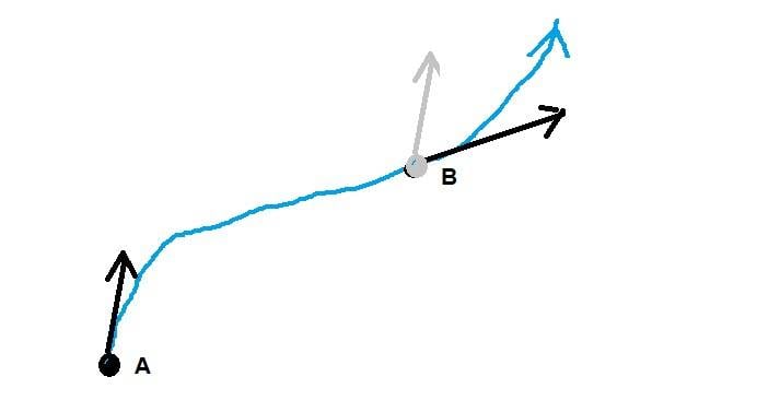

No, T is pointing perpendicular to the curve. Here's an illustration of what is meant by parallel transport.
We have a curve drawn in blue. The tangent vectors at two points, A and B, are drawn in black. The vector drawn in gray is the parallel-transport of the tangent vector at A to the point B. Since the parallel-transport of the tangent vector at A is not equal to the tangent vector at B, that means the curve is not a geodesic.
Likes PeterDonis and Dale
Yes sir got it now...thank you
