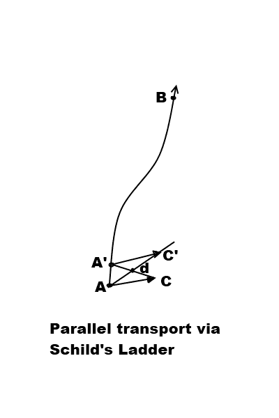

I'll mention a little known technique for graphically parallel transporting vectors, known as Schild's Ladder.
You'll find the original textbook source in MTW's book "Gravitation".
To apply it you need to know how to draw geodesic curves on your surface, and be able to measure out equal intervals along the curves. If we can measure distances, "equal intervals" just means "equal distances".
You can think of geodesic curves as being analogous to "straight lines" for this exercise, due to the property of geodesics that they are the curve of the shortest distance lying wholy on the surface that connects two points.
Because geodesic curves on a sphere are great circles, one has all the tools one needs to use this technique to parallel transport curves along a sphere.
We start with some general curve AB, which does not have to be a geodesic, and some vector, AC.
We want to parallel transport AC along the curve to B. But we need to do this in steps.
Only one of many such needed steps is shown on the drawing.
The first step consists of finding some point A' on the curve AB that's close to A. Then the curve segment AA' will be basically "straight", i.e. a geodesic.
Next we find the midpoint of A'C, and label that d.
We draw a geodesic ("straigh line") from A to d and beyond. We mark the point C' such that Ad == dC' as per the diagram, i.e. point d is the midpoint of AC'
Then, in the limit as we make A' close to A, A'C' is the parallel transported version of AC. We have to repeat the step many times in order to get all the way to B, however.
This works because in the absence of torsion (something that GR presupposes), a 4-sided geometric figure (i.e. a quadrilateral) with two pairs of equal-length sides is a parallelogram. And the sides of a parallelogram are parallel.
This technique is rather similar to a graphical device known as a pantograph
