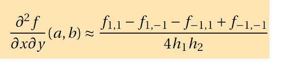

Hello,
I want to estimate a set of parameters by trying to minimize the sum of squares wrt to the parameter set given a simulation of a markov process and real data in Matlab. I have already implemented the Levenberg-Marquart (LM) Algorithm and it is converging to certain values and it is reasonably good.
But now I want to implement the Newton Raphson method, since it (should be) is more accurate. I don't care how long it will take. I am pretty sure that I am evaluating the Jacobian correctly since I am using it in the LM Algorithm. However I have doubts evaluating the Hessian Matrix:
First, I approximately calculate the 2nd derivatives of my Simulation wrt to all parameters using the equation attached below as "2nd derivative approximation for diagonal elements" for diagonal elements and using the equation attached below as "2nd derivative approximation for off diagonal elements" for off diagonal elements.
To evaluate the derivatives I have to step the parameter values one by one (in this case by 1%) and simulate the model (see 2nd block of code). I am not sure whether I did this correctly. My second doubt about the Hessian is the first term given in the equation. We have to sum over i and multiply the residual by the Hessian matrix. The residual ri(theta) is a n x 1 vector where n is the number of data points and Hi(theta)is a p x p x n Matrix where p is the number of parameters. I am not sure if I have implemented this correctly in the code (see 1st block of code).
Hessian:
The Algorithm
Code:

Evaluating h
Code:
function [h] = Evaluate_h(input_file_string, output_file_string, parameter_names, parameter_values, experiment_file_string, Simulation_Step_Time, Simulation_Time, offset, subsampling_rate, Data_Current)
for i=1:length(parameter_values)
    for j=i:length(parameter_values)
        if j~=i
            %Compute Sum of Squares at 1,1
            parameter_values_dummy=parameter_values;
            parameter_values_dummy(i)=parameter_values(i)*1.01;
            parameter_values_dummy(j)=parameter_values(j)*1.01;
            Simulation_Current_11 = Simulate1(input_file_string, output_file_string, parameter_names, parameter_values_dummy, experiment_file_string, Simulation_Step_Time, Simulation_Time, offset, subsampling_rate);
            %Compute Sum of Squares at 1,-1
            parameter_values_dummy(j)=parameter_values(j)*0.99;
            Simulation_Current_1m1 = Simulate1(input_file_string, output_file_string, parameter_names, parameter_values_dummy, experiment_file_string, Simulation_Step_Time, Simulation_Time, offset, subsampling_rate);
            %Compute Sum of Squares at -1,1
            parameter_values_dummy(i)=parameter_values(i)*0.99;
            Simulation_Current_m11 = Simulate1(input_file_string, output_file_string, parameter_names, parameter_values_dummy, experiment_file_string, Simulation_Step_Time, Simulation_Time, offset, subsampling_rate);
            %Compute Sum of Squares at -1,-1
            Simulation_Current_m1m1 = Simulate1(input_file_string, output_file_string, parameter_names, parameter_values_dummy, experiment_file_string, Simulation_Step_Time, Simulation_Time, offset, subsampling_rate);
            %step sizes
            step_size_1=0.01*parameter_values(i);
            step_size_2=0.01*parameter_values(j);
            %Compute Derivative
            h(i,j,:)=(Simulation_Current_11-Simulation_Current_1m1-Simulation_Current_m11+Simulation_Current_m1m1)/(4*step_size_1*step_size_2);
            h(j,i,:)=h(i,j,:);
        elseif j==i
            %Compute Current at 0
            Simulation_Current_0 = Simulate1(input_file_string, output_file_string, parameter_names, parameter_values_dummy, experiment_file_string, Simulation_Step_Time, Simulation_Time, offset, subsampling_rate);
            %Compute Current at +1
            Simulation_Current_1 = Simulate1(input_file_string, output_file_string, parameter_names, parameter_values_dummy, experiment_file_string, Simulation_Step_Time, Simulation_Time, offset, subsampling_rate);
            %Compute Current at -1
            Simulation_Current_m1 = Simulate1(input_file_string, output_file_string, parameter_names, parameter_values_dummy, experiment_file_string, Simulation_Step_Time, Simulation_Time, offset, subsampling_rate);
            %step size
            step_size=0.01*parameter_values(j);
            %Compute Derivative
            h(i,j,:)=(Simulation_Current_1+Simulation_Current_m1-2*Simulation_Current_0)/(step_size^2);
        end
    end
end
Just two remarks:
1- from a numerical analysis standpoint: in my experience, a 1% variation to estimate derivatives is too large by several orders of magnitudes - unless your function is exceptionally smooth (and flat)
2- from a software test&development standpoint: did you test your code with some simple test cases, whose result you already know by some other mean?
