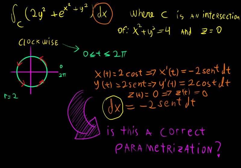

- Homework Statement
- Help with parameterize the intersection as shown in the figure
- Relevant Equations
- x^2+y^2=4 and z=0
Oh my bad i was copying my notes into that picture so that it would be easier to understand them and messed up those arrows, yes they should be going clockwise. anyways, i type "sen" because i speak spanish, sorry about that.FactChecker said:You say that you are going clockwise, but your arrows and equations look counterclockwise.
Other than that, it looks ok to me. Shouldn't all those 'sen's be 'sin's?
I think i get it now, thank you so muchFactChecker said:Your y(t) equation will make it go around counterclockwise.
... and "sin" en español means "without".xodaaaaax said:anyways, i type "sen" because i speak spanish
