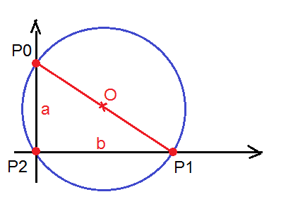

Given the points P0 = (0,a), P1 = (b,0), P2 = (0,0), write the parametric equation of a circle that intersects the 3 points.
Assume that b > a and both are positive.

I'm having a really hard time visualizing parametric equations. I drew the circle and know that the challenge is finding the center, but I don't know how to express it. the circle is shifted right and up. I don't know how to express the coordinates of the center in terms of P0 and P1 as well as so it would intersect both these two points as well as (0,0).
The three given points ##P_0##, ##P_1## and ##P_2## are known. They all have the same unknown distance ##r > 0## to the unknown center ##(h,k)##. Can you use this to set up and solve a system of equations in these unknowns?
A useful property of a circle is that the center point is the same distance from all points on the rim. So where are the points that have the same distance from (0,0) and (b,0) ? same for (0,0) and (0,a) ?
Would it look something like this..?

No, that is not where the circumcenter is. The points form a right triangle so the hypotenuse is a diameter. That is what makes the problem easier.

Making a sketch, one sees that it is really a right triangle and where the center of the circle is, and to find the radius is also very easy.
Pratik wants answers instead of questions, not guidance to help him find it by himself (and thus gain some insight). OK.
Well, the points that are equidistant from (0,0) and (b,0) are on x=b/2.
Once you know what you are looking for, a parametric equation isn't so hard to write down.
Erszebeths's picture is worth a thousand words ... or more.
