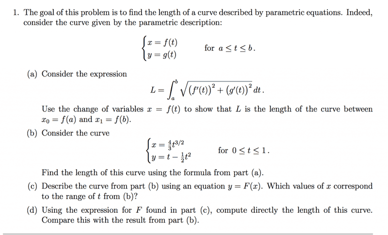

For part A) my answer was:[/B]
[itex]\int_a^b \sqrt{(dx/dt)^2+(dy/dt)^2}dt[/itex]
The work I used for part A was based off this sites explanation: http://tutorial.math.lamar.edu/Classes/CalcII/ParaArcLength.aspx
For part B)
I simple took the derivatives with respect to t of the giving x and y functions then squared them and solved the integral from 0 to 1.
The answer I received was 3/2.
I have strong verification that this is correct.
Part C)
Part C is where I am stuck. When they say y=F(x) I usually connect a capital F with the antiderivative. Does this hold true?
How do we describe the curve using y=F(x)?
Part D seems rather straightforward once part C is understood.
Thank you for any help.
You are given [tex]x= (4/3)t^{3/2}[/tex] and [tex]y= t- (1/2)t^2[/tex] and you want to write y as a function of x.
Solve the first equation for t as a function of x and replace the t in the second equation with that.
Likes RJLiberator
[(3/4)*x]^(2/3)=t
y = [(3/4)*x]^(2/3)-(1/2)([(3/4)*x]^(2/3))^2
This is writing y as a function of x, correct?
So now with this information I can plug in x = 0 and x = 1 to get the range of x?
And then I can use this equation to solve for part D? I assume.
Kind regards.
RJLiberator said:
[(3/4)*x]^(2/3)=t
Correct? Hard to say. If you would write it in Latex it would be readable.
No. Those are the end point ##t## values. What are the corresponding ##x## values?
Likes RJLiberator
Perhaps I need to use
(3x/4)^(2/3) = t and let 1 be 1 and 0 to find the range.
Thus the range would be from 0 to 4/3
Yes, the range is from x= 0 to x= 4/3. But I see no reason to solve for t to find that. You were given that [tex]x= (4/3)t^{3/2}[/tex] just set t equal to 0 and 1 in that.
Likes RJLiberator
Excellent. Yes, thank you for confirming the result and showing the way.
