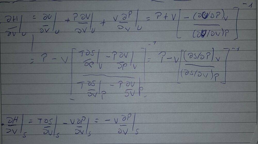

Write the following partial derivatives in terms of heat capacity (##c##), compressibility (##\kappa##) and coefficient of thermal expansion (##\alpha##).
##(\frac{\partial H}{\partial V})_U##
##(\frac{\partial H}{\partial V})_S##
With ##H##: enthalpy, ##U##: internal energy, ##V##: volume, ##S##: entropy and the subscript denotes a magnitud held constant in differentiation.
##dH=dU+Pdv+vdP##
##dU=TdS-PdV##
I've attached images showing my progress. I have used Maxwell relations and the definitions of ##\alpha##, ##\kappa## and ##c##, but I don't know how to continue. Can you help me?

Your picture is unreadable.
You have that ##H = U + PV##. And you also have that ##dU = T dS - P dV##. So when ##U## is constant, you have: ##dH = d(PV) = PdV + V dP##. And you also have when ##U## is constant, ##TdS - PdV = 0##. So we conclude:
##\frac{\partial H}{\partial V}|_U = P + V \frac{\partial P}{\partial V}|_U##
Now, if you think of ##P## as a function of ##S## and ##V##, then
##\frac{\partial P}{\partial V}|_U = \frac{\partial P}{\partial V}|_S + \frac{\partial P}{\partial S}|_V \frac{\partial S}{\partial V}|_U##
At this point, you can use ##TdS - PdV = 0## (when ##dU = 0##) to rewrite ##\frac{\partial S}{\partial V}|_U##, and you can use one of the Maxwell relations to rewrite ##\frac{\partial P}{\partial S}|_V##.
