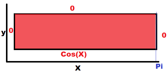

Consider the Laplace Equation of a semi-infinite strip such that 0<x< π and y>0, with the following boundary conditions:
\begin{equation}
\frac{\partial u}{\partial x} (0, y) = \frac{\partial u}{\partial x} (0,\pi) = 0
\end{equation}
\begin{equation}
u(x,0) = cos(x) \text{for}\ 0<x<\pi
\end{equation}
\begin{equation}
u(x,y) = \to 0 \ \text{as} \ y \to 0 \ \text{for}\ 0<x<\pi
\end{equation}

I am asking if I setup the problem right so far.
The visualization (i.e my picture of how I visualize the problem) The boundary conditions.

No: you said that ##u_x(0,y) = 0## and ##u_x(0,\pi) = 0##: I assume you want ##u_x(0,y) = u_x(\pi,y) = 0##. If so, your boundary conditions in the diagram are incorrect: you do not need to have ##u = 0## on the vertical sides; you need ##u_x = 0## on the sides.
Furthermore, you say that ##u(x,0) = \cos x## for ##0 < x < \pi##, and you also say ##u(x,y) \to 0## as ##y \to 0##. These contradict each other; which do you mean?
Yes, I want ##u_x (\pi,y) = 0,## sorry for the confusion. And also, I meant to write as ##y \to \infty##
