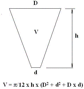

1. I have a cone frustum with known height (h) and known base diamter (d) and cap diameter (D). From this, I can calculate the volume. Question: if the frustum is half full of liquid, how can I calculate the height of the liquid?
2. V = pi/12 x h x (D2 + d2 + D x d)
3. I guess I need to calculate the cone angle to solve this but after that I'm lost

Draw a picture, you will find that the difference of 2 radius involved (I do not understand your notation) and the height form a right triangle. you can eliminate one of the radius using the pythagorean theorem.
Sorry you have lost me. I understand what you are saying - the angle is a constant and it must fit in there but I am totally lost. Here is the formula and an image.
In case anybody else is reading - I have a value for D, d and h. The above formula gives me Volume, V. Now, if I halve the volume of liquid in the cone frustum, how can I obtain the new height?
use the fact that
[tex] Tan \theta = \frac h {D - d} [/tex]
[itex] \theta [/itex] is the wall angle.
Since this is constant you must also have
[tex] \frac h {D - d} = \frac {h_2} {D - d_2} [/tex]
where the supscripted quanities are the half volume values.

You know that
Tan [tex] \theta = \frac h {R-r} [/tex]
Perhaps that replacement will cancel some factors.
You have a cubic in [itex] h_2 [/tex] there is no easy closed form method of factoring this. One way would be to put in numbers and plot it.
