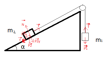

(the photo is below) The angle between the inclined plane and the surface is α. The coefficient of friction between block 2 and the inclined plane is k. Find the ratio inequality of m1 over m2 that the system remains still.
Answer: for m2 to go down: m1/m2>sina+k∗cosa
for m2 to go up: m1/m2<sina−k.cosa
For the system to remain balanced: sina−k.cosa<m1/m2<sina+k.cosa
Could somebody explain to me why the answer should be the above and not sina+k.cosa<m1/m2<sina−k.cosa?
Thank you very much!!!
I combined the two inequalities but it doesn't match the answer hints so I'd love it if someone could explain to me how that makes sense.
(sorry for my poor English)

First of all the diagram does not match the statement of the problem. The diagram shows block ##m_1## on the incline but the problem says "The coefficient of friction between block 2 and the inclined plane is k." We will go by the diagram.
Secondly, you need to draw two free body diagrams (FBDs)
FBD_1 for the block on the incline when it is just about to slide up but is still at rest.
FBD_2 for the block on the incline when it is just about to slide down but is still at rest.
That should show you how the forces on the block add. Also note that the tension in this case is equal to the weight of the hanging block. Write out the forces first, then consider taking the ratio of masses.

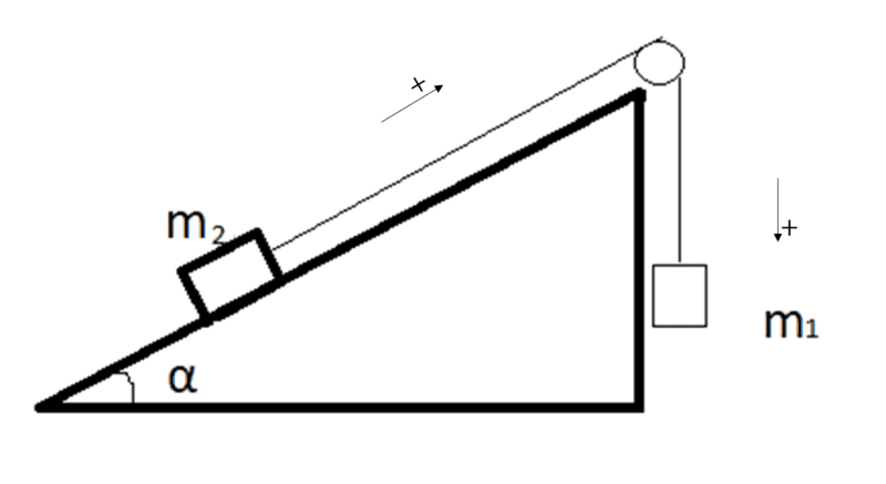

Your attachment link no longer works. Please load the diagram directly into a post.

If you think that you understand what's going on, you can fix it by reposting a complete solution. That will summarize what has been discussed and will guide the thinking of anybody else you might have to solve this problem in the future.
Memo said:
I understand now, thank you so much!
Saying you understand and showing you understand are different things.
I can't find the edit option so I guess I just put it here
