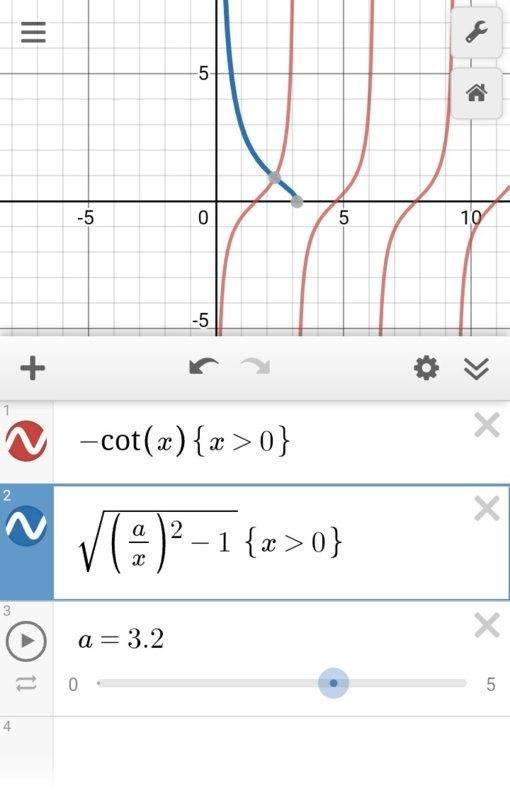

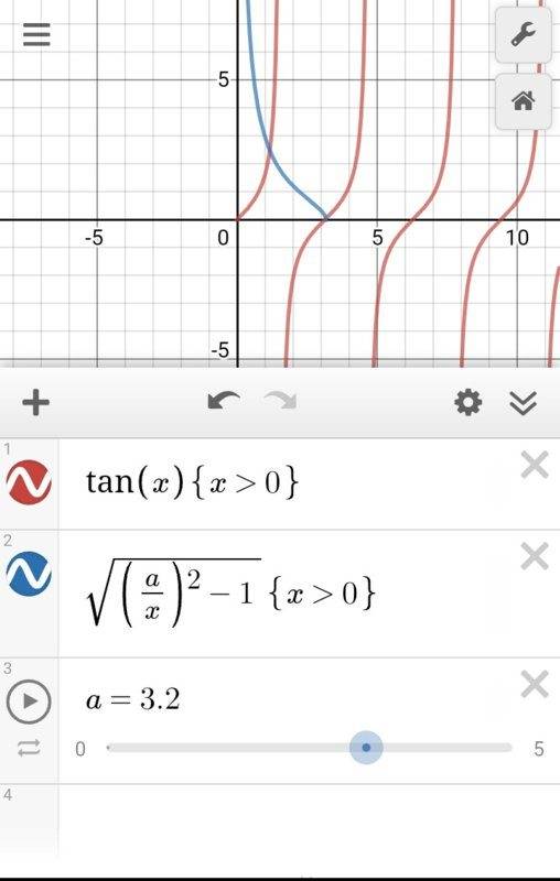

Hi! I understand the most of this example problem, I have no problem with A), which the answer is the relation tan(√(2ma^2(E+V0)/h^2)=-√(E+V0/-E), and I mostly understand B), it is just one part in the end I can't follow. Choosing the tangens function so that it only has one period in the corresponding intervall -V0<E<0 and the equations only have one point that they meet in. Therefor we put that pi/2 < √(2ma^2(E+V0)/h^2) <3pi/2 since pi/2 to 3pi/2 is a period for a tangens function, but from there they say that the equation gives pi^2*h^2/8ma^2 < V0 < 9pi^2*h^2/8ma^2, but I don't follow this step. What happened to E, why are you allowed to take it away? Shouldn't it be pi^2*h^2/8ma^2 < V0 + E < 9pi^2*h^2/8ma^2 (instead of just V0)?

Are you sure it is ##\tan## function only? Please check your solution. For that you don't need the restriction π/2 to 3π/2. The curve will always intersect the graph between 0 to π/2. See the graph below.
If you meant ##\cot## then the restriction applies. In that case simply note that since by defination of bound state ##-V_0 \leq E \leq 0##, ##E+V_0## is positive only if E=0 for then only inequalty is valid. See below.
In both the graphs I have changed variables for my convenience.
