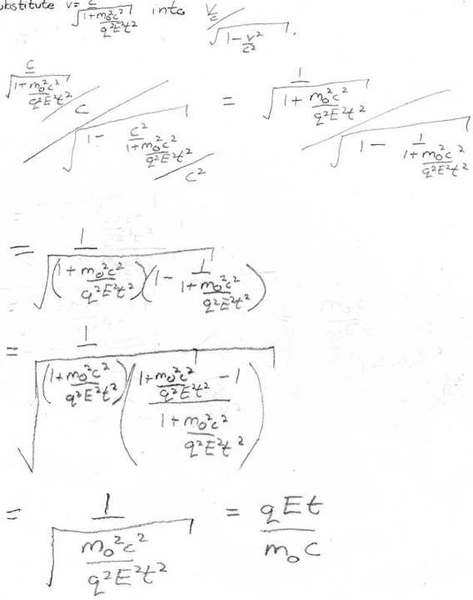

1. A particle of charge q and rest mass [tex]m_0[/tex] is accelerated from rest at t=0 in a uniform electric field of magnitude E. All other forces are negligible in comparison to the electric field force. Show that after a time t the relativistic expression for the speed of the particle is:
[tex] v=\frac{c}{\sqrt{1+\frac{m_0^2c^2}{q^2E^2t^2}}}[/tex]
I think the equations relevant here have got to be [tex]E_k=(\gamma-1)m_0c^2[/tex] and [tex] E=\frac{F}{q} [/tex].
I've tried rearranging the above equations and substituting them into each other but I can't get anything good. Does anyone know any other useful equations that I might be able to use?

Hint: with that v, what is (v/c)/√(1 - v2/c2) ? :wink:

No :biggrin:, I meant what is (v/c)/√(1 - v2/c2) if [tex] v=\frac{c}{\sqrt{1+\frac{m_0^2c^2}{q^2E^2t^2}}}[/tex] ? :wink:
Ah, darn. Let me see:
[tex]\frac{{\frac{c}{\sqrt{1+\frac{m_0^2c^2}{q^2E^2t^2}}}}{c}}{\sqrt{1-\frac{(\frac{c}{\sqrt{1+\frac{m_0^2c^2}{q^2E^2t^2}}})^2}{c^2}}}[/tex]
[tex]\frac{{\frac{c^2}{\sqrt{1+\frac{m_0^2c^2}{q^2E^2t^2}}}}}{\sqrt{1-\frac{(\frac{c^2}{{1+\frac{m_0^2c^2}{q^2E^2t^2}}})}{c^2}}}[/tex]
[tex]\frac{{\frac{c^2}{\sqrt{1+\frac{m_0^2c^2}{q^2E^2t^2}}}}}{\sqrt{-\frac{m_0^2c62}{q^2E^2t^2}}}[/tex]
Ummm, am I doing it correctly? I've got a complex number as the denominator! =S
uhhh? whadya do? :confused:
should be qEt/m0c :wink:
magic!
