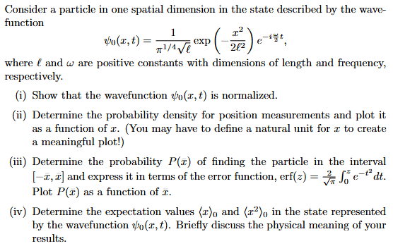

Hi,
I try and solve this problem
I have solved the problem in different parts
But me not sure how to plot the graph. Maybe someone knows?
Merci

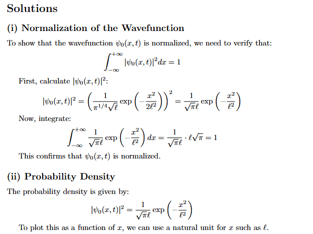

With a plotting program? Excel has the ERF function that you can use.
merci
I plotted in overleaf latex
Do you know if the other parts (i) (ii) (iii) (iv) are good?
Best wishes to you
What do you think? There comes a time when you need to troubleshoot your own work. Look at your answers and try to prove them wrong. If you can't, then they are probably correct.
For example, in (i) when you integrated did you get 1 or did you not?
In (ii), is you answer the magnitude-squared of what you got in (i) or is it not?
And so on.
