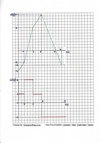

I have attached a corrected v-t diagram
when v is negative along a line segment, the area under rhe curve should be negative.
so in this case:
0 < t < 2s : ##x_2 - x_0 = 1/2(2)(-6) = -6ft##
2s < t < 3s: ##x_3 - x_2 = 1/2(1)(-8) = -4ft##
3s < t < 5s: ##x_5 - x_3 = 1/2(2)(16) = 16ft##
By adding up the areas from 2s to 5s we get : 16ft + (-4ft) = 12ft
5s < t < 8s: ##x_8 - x_5 = ((25+16)/2)(3) = 61.5ft## (Area of trapezoid)
8s < t < 13s: ##x_13 - x_8 = 1/2(5)(25) = 62.5ft##
15s < t < 13s: ##x_15 - x_13 = 1/2(2)(-10) = -10ft##
By adding up the areas from 8s to 15s we get: 62.5ft + (-10ft) = 52.5ft
So to answer (a) the maximum value of the velocity of the particle is 25ft/s
Is the above correct?
so in this case:
This looks mostly correct to this point. You are still calculating the trapezoid area incorrectly for 0 < t < 2s, but since the rest looks correct, I think you just forget to write down your new result for that part.
I don't follow your explanation below of why the maximum velocity is 25ft/s.
So to answer (a) the maximum value of the velocity of the particle is 25ft/s.
It doesn't really require much explanation. Look at your velocity plot and find the maximum velocity.
No, I was calculating the area from ##x_0## to ##x_2## the wrong way.
So 0 < t < 2s : ##x_2 - x_0 = (((-8) + (-14))/2) (2) = -22ft ##
By looking at the plot the maximum velocity is 25ft/s.
Likes tnich
Yes. Now how are you going to the find the maximum height?

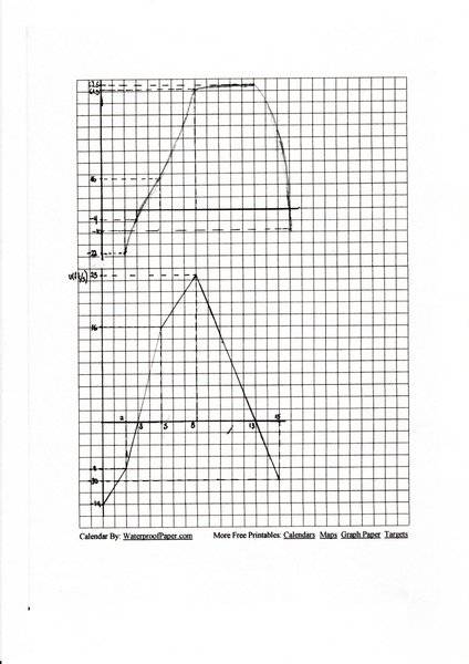

Is my x-t graph correct? Also I haven't sketched from 0 to 2s cause I don't know how it should be.
Is the maximum value of its position coordinate 62.5ft?
When acceleration is constant, the position coordinate x looks like ##x(t) = \frac 1 2 a t^2 + v_0 t + x_0##, so your plot should look like pieces of parabolas glued together (a different parabola for each constant acceleration). To find the maximum height, answer this question: what is the velocity when the height is at a maximum?
Before trying to sketch the graph of position, calculate where it will be at the end of each period.
Since you know the velocity at start and end of each period, the easiest way is to use the average velocity for the period.
Post the numbers you get, preferably as a table showing the velocities too.
For maximum height, answer tnich's question.
