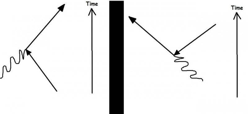

I am not sure if I understand, at a deep level, why relativity would imply the possibility of particle non-conservation, but treating space and time on an equal footing intuitively makes it compelling to me.
The following diagrams aren't seriously meant to be Feynman diagrams--they're just visual illustrations of processes involving particles. On the picture on the left, we have a pretty unremarkable process: An electron (marked by the solid line) is hit by a photon (marked by the wavy line) and is deflected. In the diagram, time is vertical and the one spatial dimension is the horizontal axis.
Now the diagram on the right is the same process, "rotated" in spacetime. In this diagram, the same process is described by: Originally, (in the bottom of the diagram), there is only a photon. At some point, the photon produces an electron-positron pair. So pair production and deflection of an electron by a photon are closely related processes. (In actuality, these simple processes have zero amplitude, because there is no way to get energy/momentum to balance for a single photon to split into an electron/positron pair.)
Likes kith
So is the point that, in spacetime it is quite natural, in some sense, for particle production to occur and such a phenomenon cannot be described in standard quantum mechanics?
