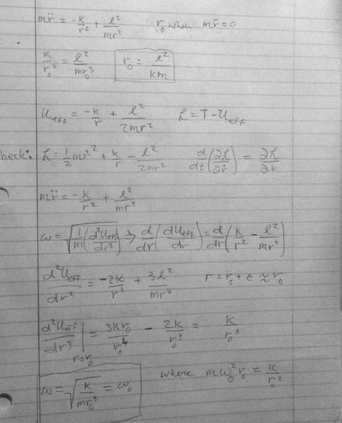

A particle of mass m moving in three dimensions is attracted to the origin by the gravitational force of a much heavier object. It can be shown that the radial motion is governed by the following equation
[itex]m\ddot{r}=-\frac{k}{r^{2}}+\frac{l^{2}}{mr^{3}}[/itex]
where k is a constant and l is the angular momentum. Determine an equilibrium radius [itex]r_{0}[/itex] in terms of k, l, and m. If the particle is put near that equilibrium radius, [itex]r=r_{0}+\epsilon[/itex](where [itex]\epsilon << r_{0}[/itex]), it will have an oscillatory radial motion about [itex]r_{0}[/itex]. What will be the frequency of that oscillation?
Attached to thread as I'm horribly slow at typing latex.
Your final answer looks correct, but I'm not quite sure what it is you've done to get it. Specifically, why do you assert that [itex]\omega=\sqrt{\frac{1}{m}\frac{d^2U_{eff}}{dr^2}}[/itex]? Is the RHS of this equation even a constant?
The method I would suggest is to just plug [itex]r=r_0+\epsilon[/itex] into your equation of motion and Taylor expand the RHS of it in powers of [itex]\frac{\epsilon}{r_0}[/itex] (since you know that it is much smaller than one).
