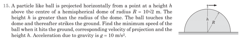

refer to image
refer to image

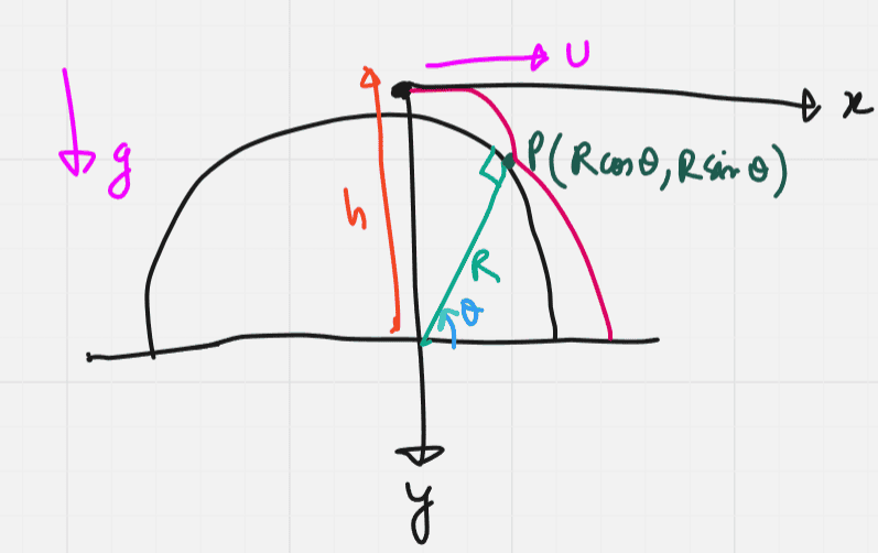

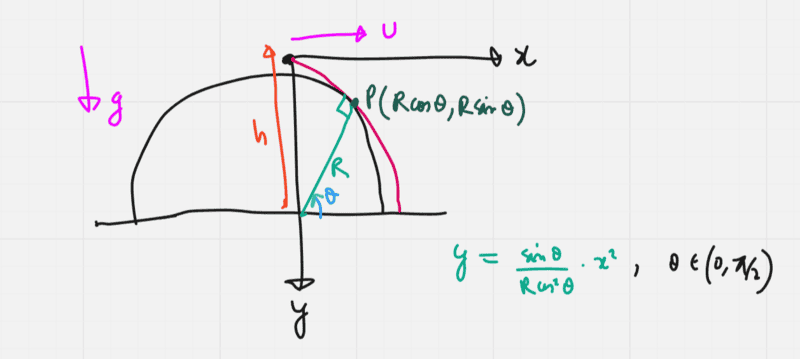

Since the ball will follow a parabolic trajectory , i threw it into the coordinate plane with particle starting from the origin .
$$y= kx^2$$ Differentiating wrt ##t## : $$ gt=2ku^2 t\implies u=\sqrt{\frac{g}{2k}}$$ where $$k=\frac{\sin\theta}{R\cos^2\theta}$$ Now , final speed when it reached the bottom is $$\sqrt{u^2+2gh}$$ but I am stuck here on how to find ##h## in terms of ##\theta## in order to minimise the expression .

Maybe i misinterpreted the 'touching' of the dome . So , the correct interpretation should be that the ball collides with the dome and changes its trajectory and then strikes the ground ? I attached the figure . @Hill , yeah absolutely ! i was careless . It should be ##P(R\cos\theta ,h-R\sin\theta)##

By the sketch, it appears that coordinates of the point P are ##(R \cos \theta, R \sin \theta)##. This is incorrect if the particle starts from the origin.

Because of the post #5 above, the $$k=\frac{\sin\theta}{R\cos^2\theta}$$is incorrect.
Bling Fizikst said:
@Hill , yeah absolutely ! i was careless . It should be ##P(R\cos\theta ,h-R\sin\theta)##.
Yes, but in fact you don't need ##\theta## at all.

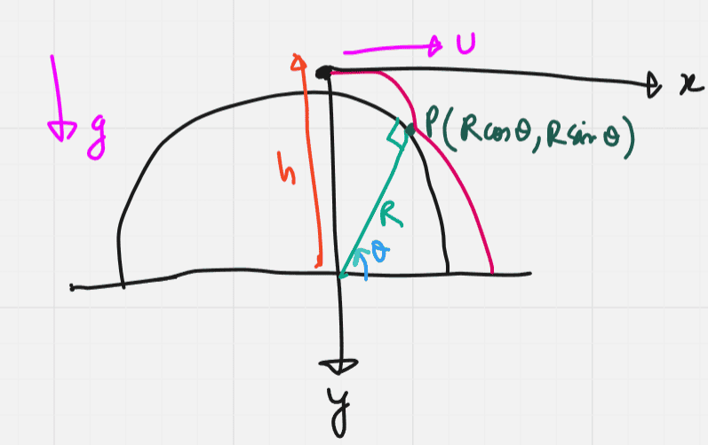

Was my original diagram correct then? If yes , after correction (thanks to @Hill) . I am getting $$\mid v_{\min}\mid =\sqrt{2gR(\sin\theta\pm \cos\theta)}$$ for ##\theta\in\left(0,\frac{\pi}{2}\right)## . Not sure how to proceed from here . The calculation looks tricky as i have to make cases for everything now. For instance , i took ##\sin\theta +\cos\theta \geq 1## and again you get different answers for taking ##\theta=0^{+}## or ##{\frac{\pi}{2}}^{-}## . All of them being wrong btw.
There is no need to involve theta. Note that both ##u## and ##h## are variables. You need a constraint on these to ensure that the ball impacts the sphere at a tangent.

You have two curves. You need to calculate the condition so that the curves are tangent at their point of intersection.
Note that, in case you haven't already seen this, the parabolic path for an initially horizontal trajectory is:
$$y = h - \frac 1 2 gt^2, \ x = ut$$$$\implies y = h - \frac{gx^2}{2u^2}$$
How about this?
Right the equation for the point ##P(x, kx^2)## to be at the distance ##R## from the dome center ##(0, h)##. You'll get a quadratic equation with solutions depending on ##k## and ##h##. Right a condition when this equation has exactly one solution, i.e., the parabola has one and only one point at the distance ##R## from the dome center. This will give you dependence of ##h## on ##k##. Then find ##k## that minimizes ##u##.

I agree. It should have been given as two steps: first find the relationship between ##h## and ##u## so that the ball touches the sphere at a tangent. Find ##h## and ##u## that minimises the speed of impact with the ground (which is equivalent to minimising the total energy of the ball (PE + KE)).
Easily one of the worst problems for physics . Continuing from : $$(kx^2-h)^2+x^2=R^2$$ When two curves are tangent to each other at a point then there is a double root , here : ##(\alpha>0)## in it . Let ##\alpha,\alpha,\beta,\gamma## be the roots of the eqn : $$k^2x^4+(1-2hk)x^2+h^2-R^2=0$$ Define ##\sigma_r## as sum of roots taken ##r## at a time . $$\sigma_1=2\alpha+\beta+\gamma=0$$$$\sigma_4=\alpha^2 \beta\gamma=\frac{h^2-R^2}{k^2}$$ $$\sigma_3=\alpha^2(\beta+\gamma)+\beta\gamma(2\alpha)=0$$ Easily eliminating ##\beta,\gamma## in ##\sigma_3## to get : $$k^2\alpha^4=2(h^2-R^2)$$ Plugging the values of ##\alpha^4,\alpha^2## in the original equation to get :$$2k\sqrt{h^2-R^2}=2hk-1\implies h=\frac{4k^2 R^2+1}{4k}$$ Now consider the speed $$s=\sqrt{u^2+2gh}=\sqrt{2u^2+\frac{g^2 R^2}{u^2}}\geq \boxed{\sqrt{2Rg\sqrt{2}}}$$ equality at ##\boxed{u=\sqrt{\frac{gR}{\sqrt{2}}}}## $$\implies k=\frac{1}{R\sqrt{2}}\implies \boxed{h=\frac{3\sqrt{2}R}{4}}$$
