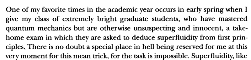

These last posts remind me of the opening paragraph in Laughlin's Nobel Lecture.
By all means, enlighten us.
Likes vanhees71
Though not difficult to trace that Lecture, what I recalled was this (in Laughlin's own words):
(https://www.nobelprize.org/uploads/2018/06/laughlin-lecture.pdf).
  • Haha
Likes vanhees71, malawi_glenn and weirdoguy
