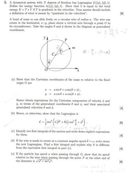

2)In attachment Q1 Last part: If the particle has speed ##u## when passing through O, show that its speed relative to the wire when passing through the point P at the other end of the diameter is ##\sqrt{u^2 + 4a^2 w^2}##. (Rest of question provided for clarity again)
Kinetic energies, angular velocity.
1)The first term in the Lagrangian is the translational kinetic energy of the mouse relative to an inertial frame and the third term is its potential energy. Introducing ##\theta## as the angle through which a point on the surface of the wheel has rotated, assuming there is no slip between the mouse and the inner circumference, then ##\dot{\theta} = \dot{s}/a##. Let ##w## be the angular velocity of the mouse wrt an inertial frame. How do we obtain ##w = \dot{s}/a - \dot{\phi}##? Why isn't ##\dot{\phi}## enough?
2) I think to get the speed at P relative to the wire then I need to solve ##v_p = 2a \dot{\phi}##. From a previous part of the question, I got that the equation of motion for ##\phi## incorporating the constraint ##\dot{\theta}=w##, is $$\ddot{\phi} + w^2 \sin \phi = 0$$ I could multiply this equation by ##\dot{\phi}##, integrate to get d/dt (expression) = constant and use the initial conditions for the velocity at O to get the constant. This would give me ##\phi## but the integral was non-elementary. Even so, if I could solve it, it would give me ##\phi(t)## and I would not know the time taken for the particle to get to P.

Can you help at all with my other question? See OP, second question.
Thanks!
I have not checked whether the equation you obtained is correct, but assuming it is, it results in some ## \dot \phi = f(\phi) ##. Consider ##f(0)## and ##f(\pi)##.
Multiplying the equation by ##\dot{\phi}##, I get that $$\frac{d}{dt} \left(\frac{{\dot\phi}^2}{2} -w^2\cos\phi\right) =0$$ so ##\frac{{\dot\phi}^2}{2} -w^2\cos\phi = \text{const} = A##
Now, ##\dot{\phi}/a = u \Rightarrow \dot{\phi}^2 = a^2u^2## where ##\phi = \pi## meaning that ##A = a^2 u^2/2 + w^2##
So now I would rearrange for ##\dot{\phi}## and find the value when ##\phi = 0##. Then ##v_p = 2a\dot{\phi}|_{\phi=0}##
That does not address #10 fully.
Yes, ofcourse and it had an error. My internet connection lapsed. I have corrected it now and added more detail. Thanks.
I wonder why you could not finish the analysis. Once you get ##A##, there are no unknowns in ##f(\phi)##. What is ##f(0)##?
I didn't get the right result, so I wanted to check my method. ##f(0) = \sqrt{4w^2 + a^2u^2}## Then ##v_p = 2a\sqrt{4w^2 + a^2u^2}##, but it is not quite the same as the answer.
How did you get that? Note that addends under the radical are incompatible dimensionally.
Where does the ##2## come from?
I see that the wrong dimensions were present already in #11, though it was not so apparent as in #15.
Okay with the corrections I obtain ##\dot{\phi}|_{\phi =0} = \sqrt{u^2 + 2a^2w^2}##. My expression for v_p came about because relative to O, P is a distance 2a away.
But is the rotation due to ##\phi## relative to O?
No, it is relative to the radius as in the sketch. So, that would mean that ##v_p = a \dot{\phi}|_{\phi=0} = a\sqrt{u^2 + 2a^2w^2}## but I seem to still be missing a factor and that is no longer dimensionally consistent.
Can you explain, as verbosely as possible, how you get that result?
Likes 1 person
Actually, it's okay, I got it. Thanks voko.
