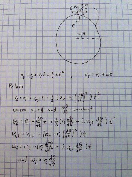

A projectile is launched from a mountain at a given angle and velocity (which is large). Using polar coordinates find the position of the particle at time t. I'm ignoring drag (for now).
I tried using the polar kinematic equations: http://mathenthusiast.com/physics/mechanics/kinematic-equations-in-polar-coordinates/
I have a python program that uses a numerical Euler method to find the path of the projectile. I want to use the polar kinematic equations to ensure I did things correctly and to see the discrepancy between numerical and kinematic answers. I first tried using cartesian coordinates, but ran into issues with splitting the gravitational force into x and y components. The velocity is high enough that I can't treat gravity as acting only in the y direction.
Unfortunately, the answers I get are quite different. When using the polar kinematic equations, my velocity in the theta unit vector direction is increasing over time (enough so that my total velocity increases as well). Can someone show me what the equations of motion should look like in polar coordinates?

It seems to me there should be a way to do things in polar. I've found lots of google help with cartesian mechanics though and very little in polar coordinates.
The projectile is moving very fast ie multiple km/s, so the gravitational acceleration vector can change direction from straight down.
Here is a quick write up of what I've been trying (which seems to be wrong) and a drawing. I think I'm misunderstanding something in my acceleration terms and/or unit vectors.
Edit: I know that the acceleration component for my theta is wrong...I'm just how to find the correct term...seems like I need a 1/(r initial) otherwise my theta values go crazy.

So is your coordinate system wrt the firing muzzle or wrt the center of the Earth ?
Anyhow, the things you claim constant are not constant if Earth isn't flat enough!
Center of the earth. What I want are equations that describe the projectile's motion giving me theta, r, omega, and radial velocity using my starting values for v, theta, angle of projectile launch.
Which "constants"? The idea with using the center of the Earth as the origin is that there should be no real forces acting in the theta direction. So my only acceleration in that direction would be due to the movement of the coordinate unit vectors. Whereas gravity should always act only in the r direction. I should have mentioned that I'm ignoring the change in the gravitational field strength of the Earth as I move farther away. I'd be happy to include that, but don't know if it's possible.
Ok, I see. (I saw the ##\hat r ## and the ##\hat \theta## at the firing position, so I drew the wrong conclusion).
But ar = ##\vec g## confused me no end. I understand you mean ##\vec a = - \vec g\ ## (not constant) and ## a_r = -|\vec g|\ ##, a number (constant).

Why is ##d\theta\over dt## a constant ?
I understand ##\vec F## is central, so the angular momentum ##\vec L = \vec r\times\vec p## is constant.
This follows from the second equation: ##{d\over dt}\left (r^2\dot\theta\right ) = r^2\ddot\theta + 2r\dot r\dot\theta = r\left(r\ddot\theta+2\dot r\dot \theta\right) = 0##
You can't just copy the SUVAT equations and replace x, v and a by ##\theta##, ##\dot\theta## and ##a_\theta##, you'll have to solve the equation of motion.

##d\theta\over dt## I thought should be constant because the acceleration in the theta direction should be zero. I'm confused which "second equation" you are referring to. I agree with your time derivative, but I'm not sure where ##r^2\dot\theta ## comes from. How would I go about solving my equations of motion. If you provide a link, I'll be happy to do some reading.

Second equation is $$r\ddot\theta + 2\dot r \dot \theta = 0 $$the ##\hat\theta## component of ##\vec a##. That's the one that is zero, not ##\ddot \theta## !
##r^2\dot\theta ## comes from ##\vec L = \vec r\times\vec p = m\; \vec r\times\vec v= m\; \vec r\times\left (\vec\omega\times\vec r \right )##
The icbm guys do a nice job in solving.
You have two equations$$
\ddot r− r\dot \theta^2 = -|\vec g|\quad {\rm[1]} \quad {\mathsf {and} }\quad r\ddot\theta + 2\dot r \dot \theta = 0 \quad {\rm[2]} \quad
$$and you have the constant L, so ##
r^2\dot\theta## is constant. That means ##r^4\dot\theta^2## is constant too. Call it C
Eq [1] gives you ##\ddot r= r\dot \theta^2 -|\vec g| = C/r^3 -|\vec g|## so for your integration step you use this to get ##\dot r(t+dt) = \dot r(t)+\ddot r(t) * dt ## and r with ## r(t+dt) = \dot r +\dot r(t) * dt ## .
And for theta you use ##\dot\theta = \sqrt C /r^2##
